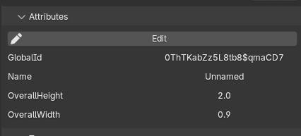

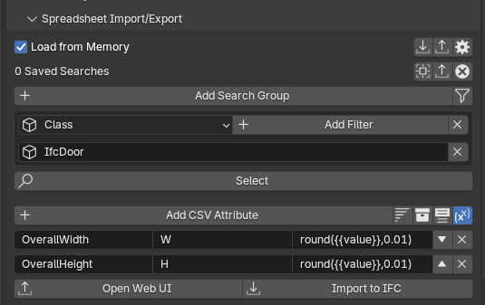

you can use attributes:

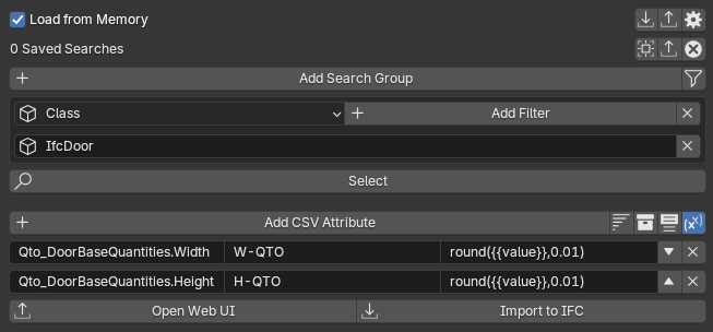

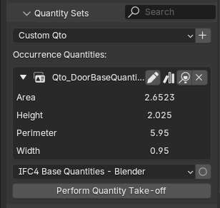

..or you can use Qto (shift-Q) to fill the Qto_DoorBaseQuantities, try Blender engine for doors:
PS difference between the two methods I believe is due to the second using the overall dimensions, including Lining
