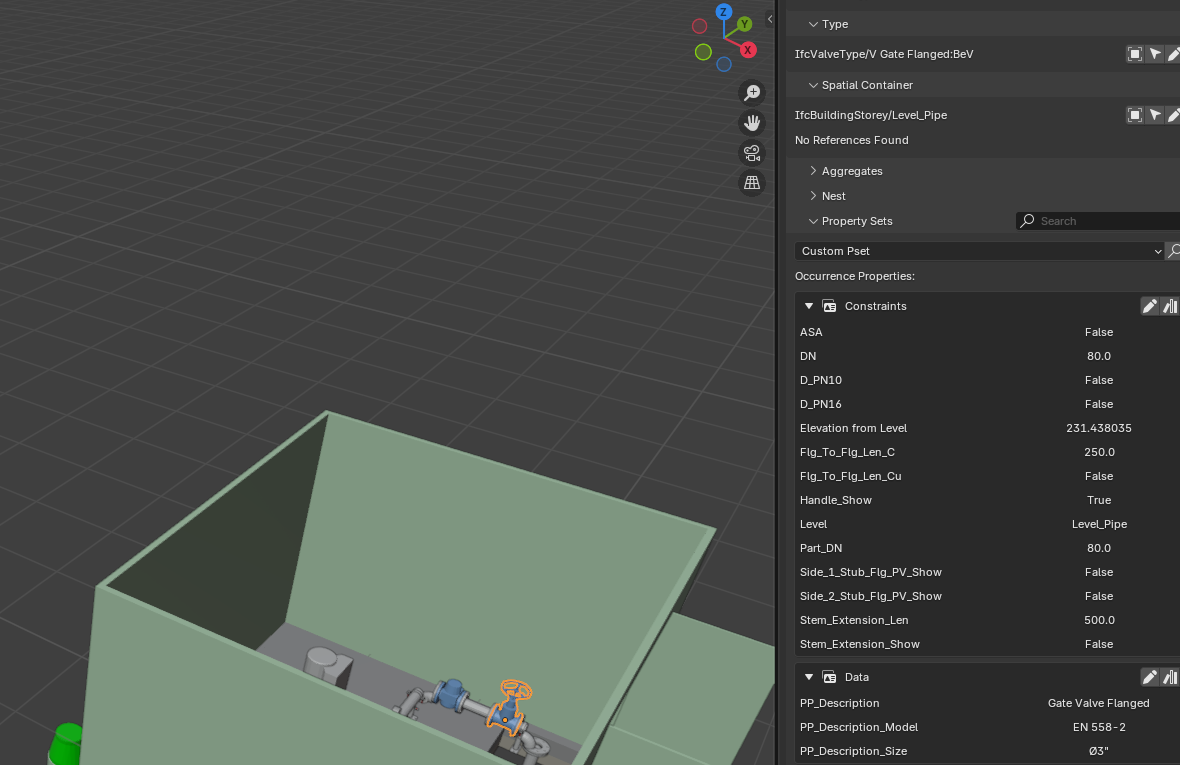

When I run a simplified script to just report the value of one named PSet on one selected object, nothing is found depsite that Object having it's PSet name and value shown in Bonsai. Does Bonsai use different PSet Names under the hood (perhaps a prefix or suffix)?

I've worked it out - the PSet is a collection. The Collection is like a dictionary of the Parameter Names and Values (Revit Project Parameters with their Values). All working now.
