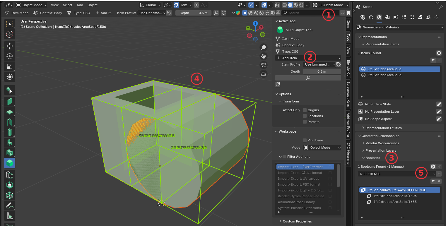

    If you want to be a bit more complex, you can go into "Ifc Item Mode" (1) and in the toolbar you can "Add Item" (2). Once you have multiple items, select two items (4), go to the Boolean section (3), and add (5) a difference, intersection or union. Note you won't see the effect until you escape back to Ifc Object Mode.

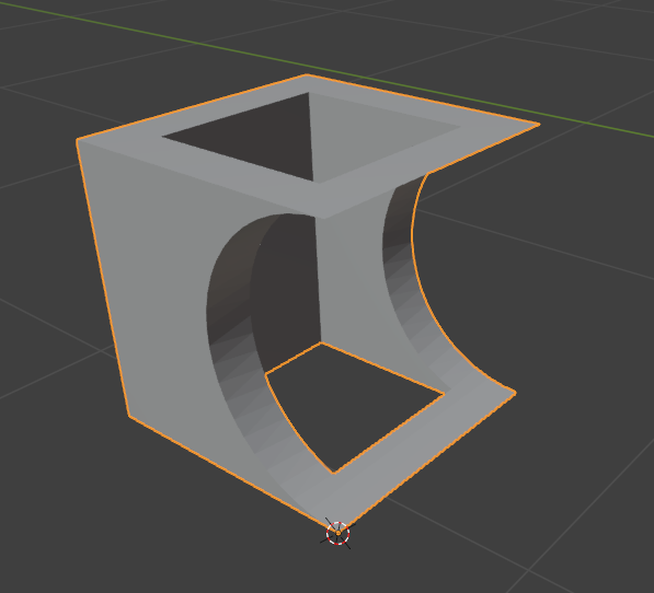

    The square object uses the first single profile with a hole method, and then the second method to cut out a horizontal cylinder section, giving:
    None of this is specific to IfcSpaces, although in this case I did create them as IfcSpaces.

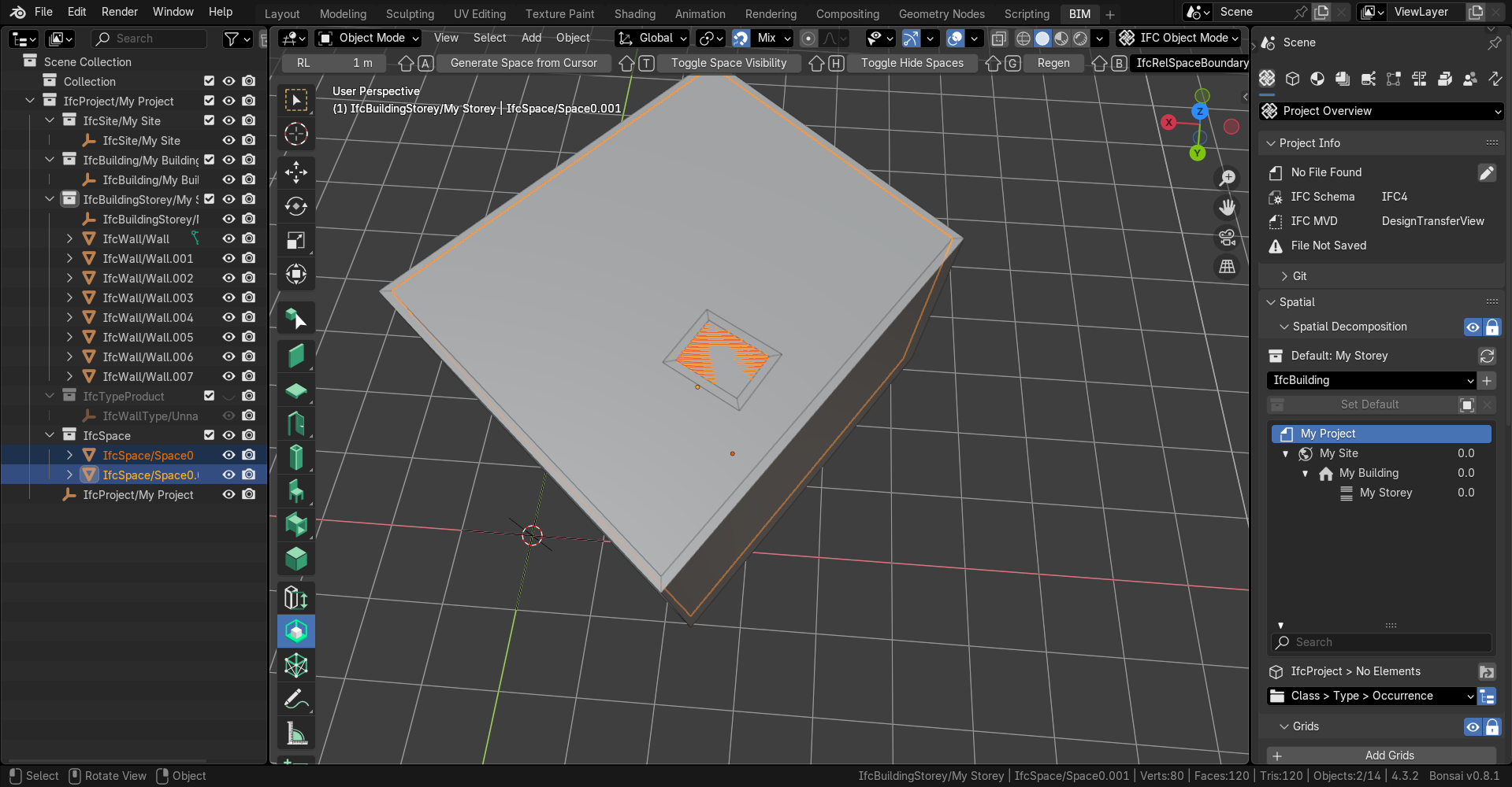

    I have an apartment space. I want to place a duct inside this space. In the end, I want to subtract the volume of this duct from the total volume of the space.
    Therefore, it is necessary to have two spaces inside each other: one is the entire space, and the other is the duct space, which is inside the larger space and creates a hole in it to reduce its volume.
  • There are two spaces. one us a duct that is inside and second is the bigger space.Here is the snapshot
