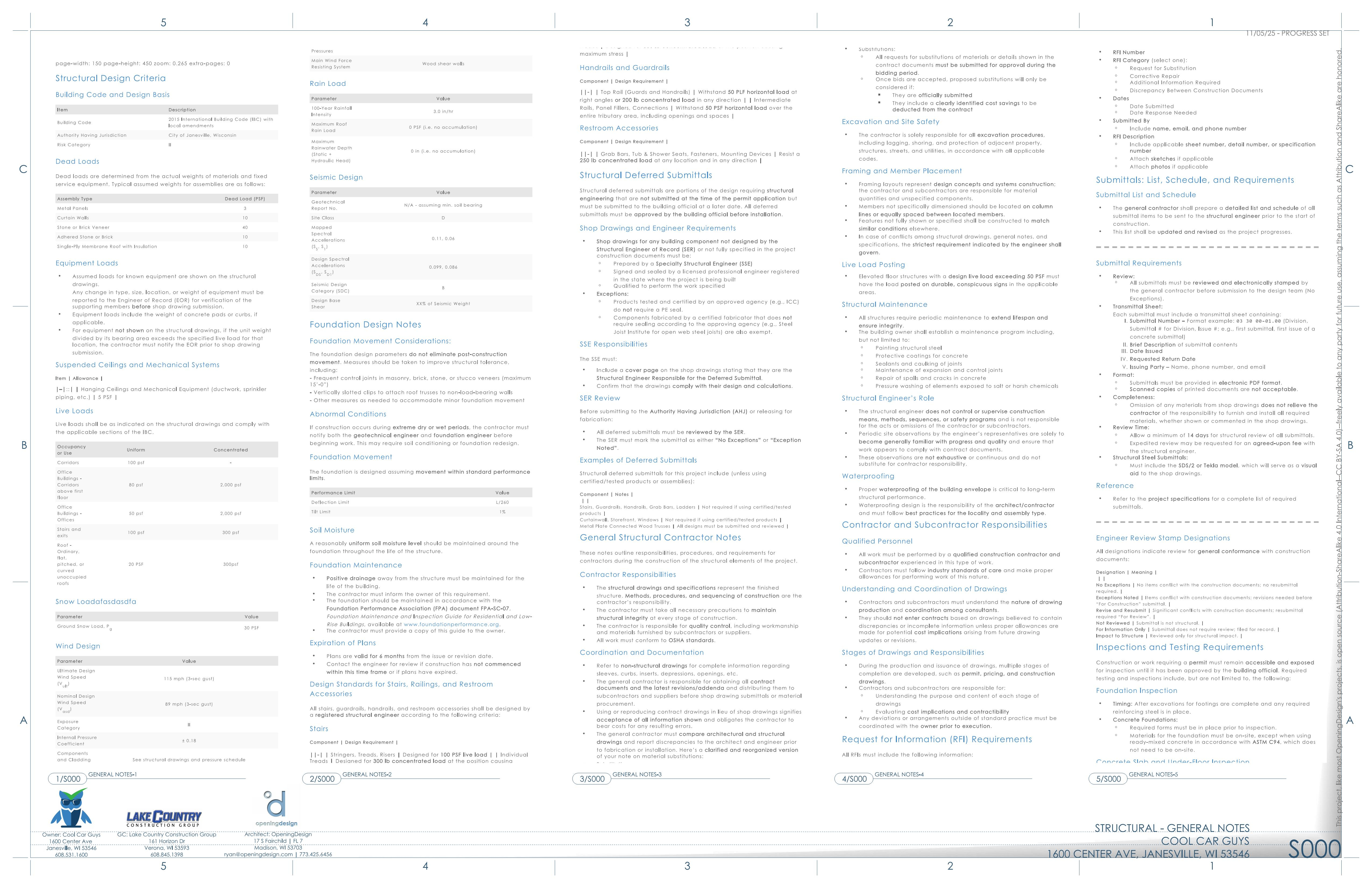

  • For example, was able to quickly convert this markdown file to these SVG files.
    I then used Bonsai to compose these referenced SVG's on to a sheet. Here's the IFC file.
    Massteverugibrunopostletlangwalpa
  • Did you notice the weirdness with lowercase "L" and capital "I" weighting and italicization?
    Also a number of tables are rendering as text instead of as tables. "Suspended ceilings and Mechanical Systems" is the first one.
    Otherwise... neat!
  • Cool, though this needs to be a python module/wheel, and bonsai needs to run it for IFC document references that point to markdown files - so all project documentation is collected/referenced by the IFC, and the SVG/HTML can be regenerated by bonsai when the markdown updates. The generated SVG should live in sub folders as drawings are currently.
    theoryshawtlang
    I did. I've noticed that happens with a few html to pdf converters.

    Oh, So this is happening here:
    .md -> .html -> .svg -> .pdf
    and the svg looks good in browsers? How peculiar!
