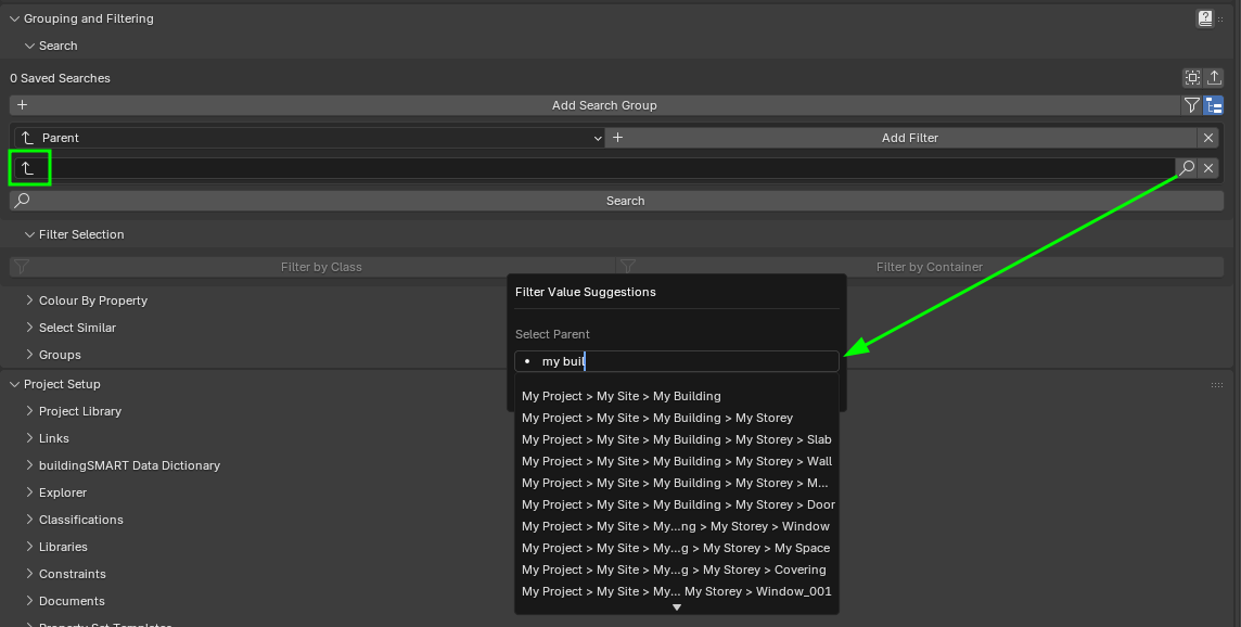

As a followup this would be the suggestion for the filtering case. To add a magnifying glass that provides the list of possible values in the current file for the corresponding element in the search menu (in Grouping and Filtering -> Search or Collaboration -> Spreadsheet Import/Export).
For the case of globalD I have followed the same idea as in enum_property_search of providing next to the globalID the ifclass name and the ifcelement name so it is easy to find).

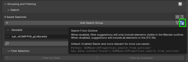

I have added a toggle so by default the search will only use the elements in the outliner and not the ifc file:
This improves the speed a lot.
Sincerely I do not know if looking to the ifc file contents to select elements that do not appear in the outliner is of any benefit. Is there any use case in which it could make sense? If not I guess I can simplify and remove the toggle and just search within the elements in the outliner?

The only thing I can think of is perhaps linked in ifc files? I've not used that, so it may be a non issue. Just a thought of the top of my head.

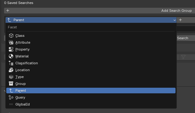

entity.is_a()model.schema.declaration_by_name()supertypeattribute@brunopostle Something like this for the case of facet "Parent"?
Or you think this should be added for all the other facets (except for Query where I am not adding any suggestion)?
