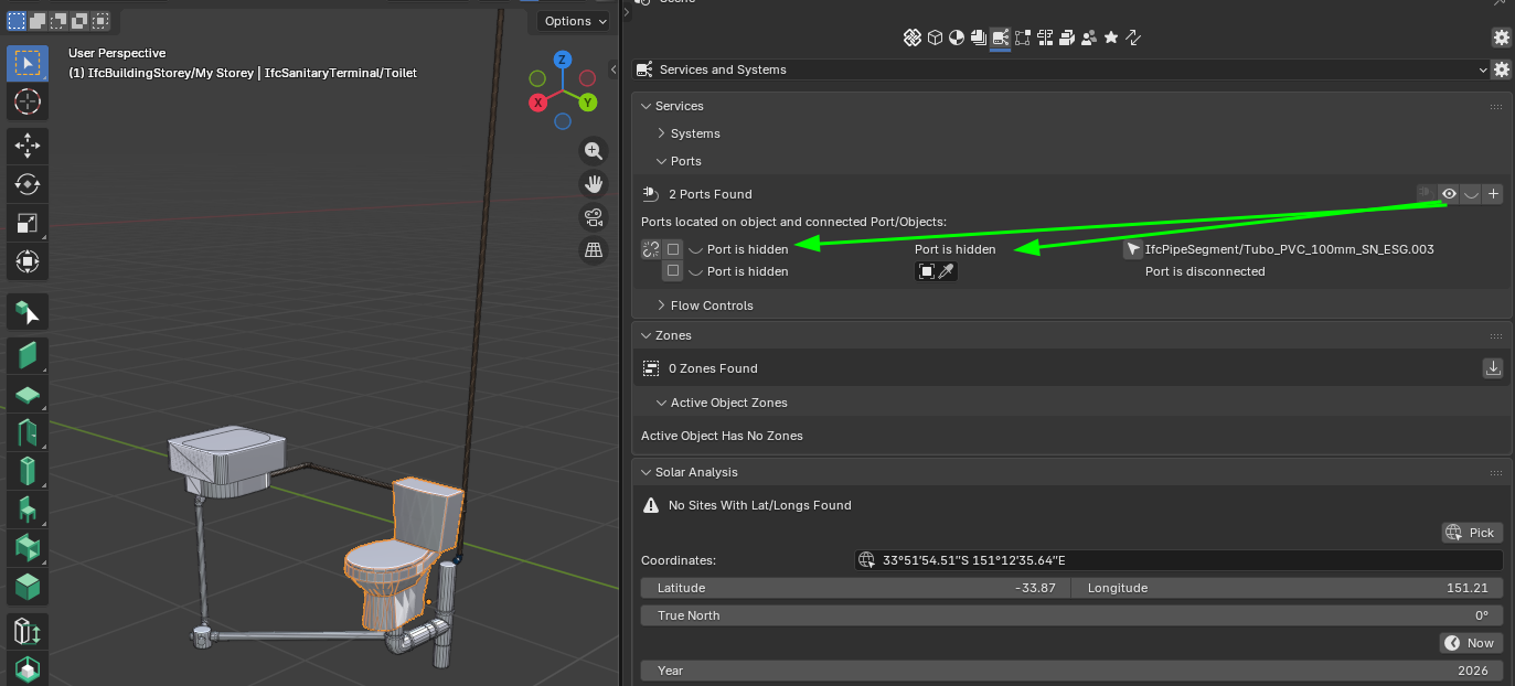

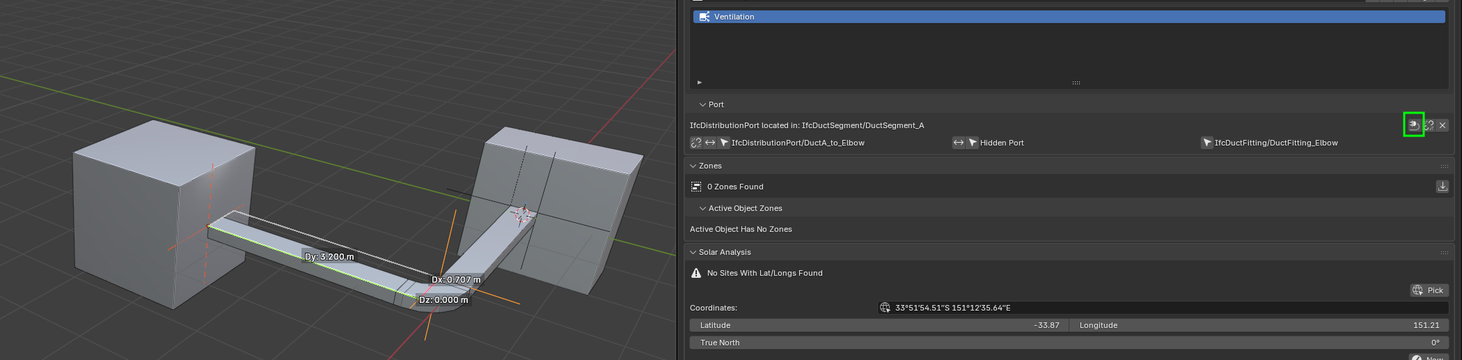

Prompted by some discussions about MEP in https://community.osarch.org/discussion/3235/ifc-blend-sync-customer-user-ui-revisited#latest I have tried myself to create a simpleMEP system by defining ducts and then adding a source and a sink. While the creation of the ducts has worked fine and the corresponding IfcDistributionPorts where connected properly I have seen that the operator add_port() was not placing by default the empty as child to the object (clicking hide_ports and then show_ports was fixing this as workaround).
I also have found that it is helpful to have the complete view of the port and the object/port to which a given port is connected in either the Port or Ports panel.
So I have created PR https://github.com/IfcOpenShell/IfcOpenShell/pull/7543 to address:
  • Properly add_port not needing to do the workaround mentioned above (the added port is of the type USERDEFINED and its SystemType equal to the predefined type of the systems if the object s assigned to a system (USERDEFINED otherwise)

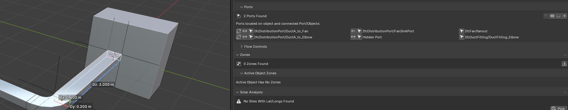

  • Updated the Ports panel:

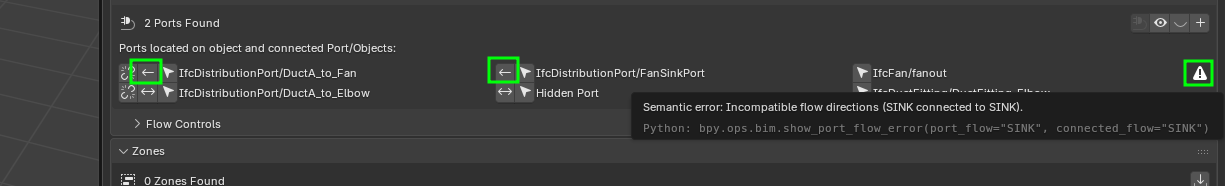

    The flow direction is an operator so clicking on it allows you to cycle over the possibilities, giving a warning for not reasonable combinations:

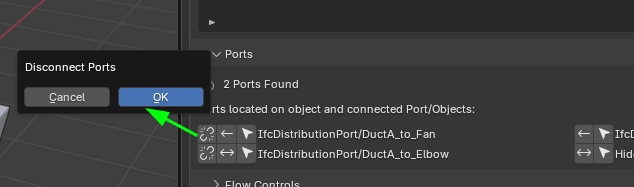

    The disconnect_port operator asks for confirmation to avoid removing connections by mistake

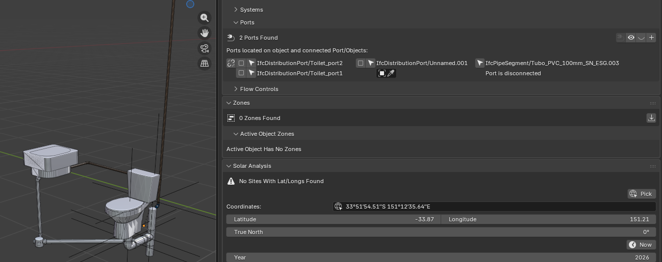

    If a port is missing a connection, a field is given for the user to add it either by eyedropper or selecting from the free, not-hidden ports
    Don't know about others, but I dislike cycling over multiple states like that. The next state is not obvious, I may have to click more than once to get to the state I want, and lastly I have a twitchy trigger finger - too often I'm trying to go too quick, and I often overshoot, making it worse.
    The way it currently is working, it does not seem to be possible to create an unreasonable combo. I switch between Source and Sink and the other port flips. I set to Source/Sink or Undefined and the other port switches to match. So having the possibility to make them mismatched seems to be a step back.

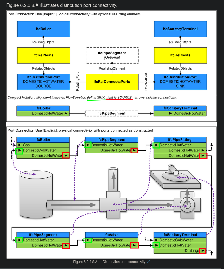

  • @sjb007 I have read more carefully the documentation and actually I was not properly interpreting left and right in the picture below:
    Now it is clear that a pipe is meant to have a pair of ports, one being the source and the other the sink. Weird to me as it makes them not symmetrical, but it is what it is :)
    Thanks for the feedback, Let me change that behavior so if one changes one port to source automatically the other becomes a sink and viceversa and if one changes to sourceandsink or undefined, the other is copied with this type.

  • I have done some small refinements with scaling the panel and also when clicking show ports that it also shows the ports of the connected objects:
    It didn't work for me. (bonsaiPR_py311-0.8.5-alpha2601090235-linux-x64)

    @walpa
    The flow icons always confuse me, but with "System/Should draw decorations" enabled, it's easy to choose the correct port/flow direction. :)
    yes, took me a while the get familiar with it, but considering the O (utlet) in Source and I (nlet) in Sink helped me a bit..
    see link
  • Thanks @steverugi, good trick!
    I always forget the meaning of the right and left arrow icons... :}
    steverugi
    Don't think of it as a physical object (a cable conducts electricity in either direction), but rather in terms of how that object is used (a pipe can conduct a fluid in one preferred direction or in both directions, depending on whether it's being pumped, for example).

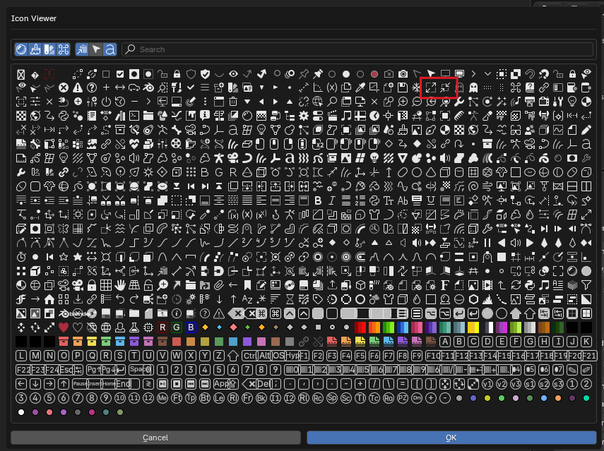

  • Yeah, those icons are terrible from an obviousness point of view. I wonder if they couldn't be improved. I've very rarely seen custom operator icons before though. I think this is partly because any custom icons will be bitmapped only - not scaled dynamic svg like the builtin ones - so they will probably look awful. This is likely why everyone tries to overload the crap out of the Blender default icons.
    I did find several images searching on "source sink fluid flow direction icon" which looked like variations of the following:
    The red-ringed icons here seem to match this concept quite well and tie in fairly well with the UNDEFINED:
    ...but then I couldn't find a satisfying combined SOURCESINK icon... So, my answer is to totally change them all:
    Maybe I'm strange, but they are more obvious than the current left/right arrows.

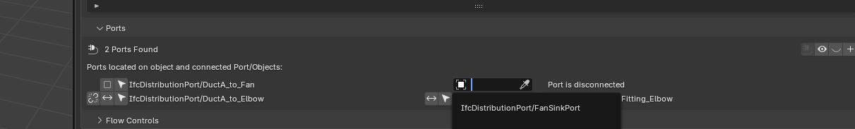

  • edited January 11
    I have updated the PR BonsaiPR v0.8.5-alpha260111-b5f7bd3 as there was a bug (thanks @DrInfiniteExplorer ! for the insights) and also made suggestions to have both the object and the port name which I think is more useful (I have removed the eyedropper as I think it does not allow to have this type of suggestions and it was not adding any other extra capabilities).
    Here yo see it:
