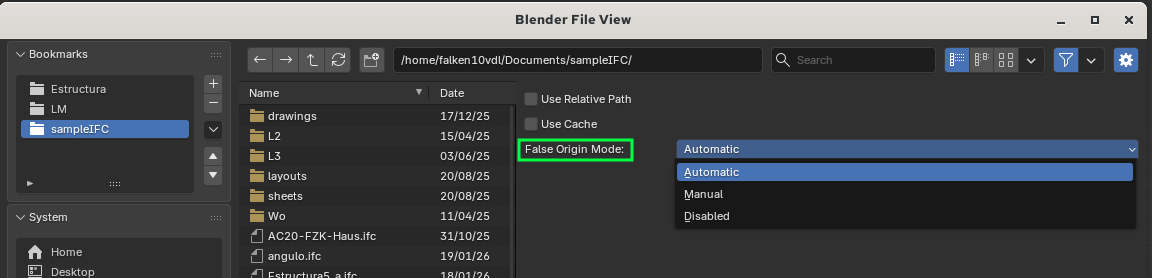

@theoryshaw said:
Great contribution!
Would it be possible to apply external styles to the links?
Added support to load external styles.

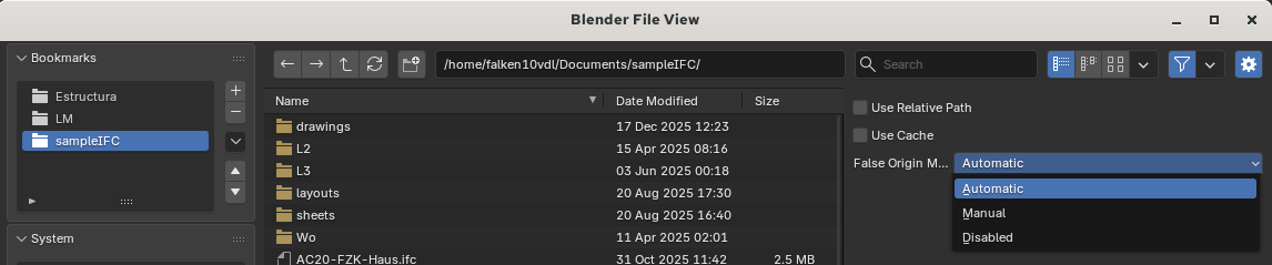

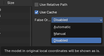

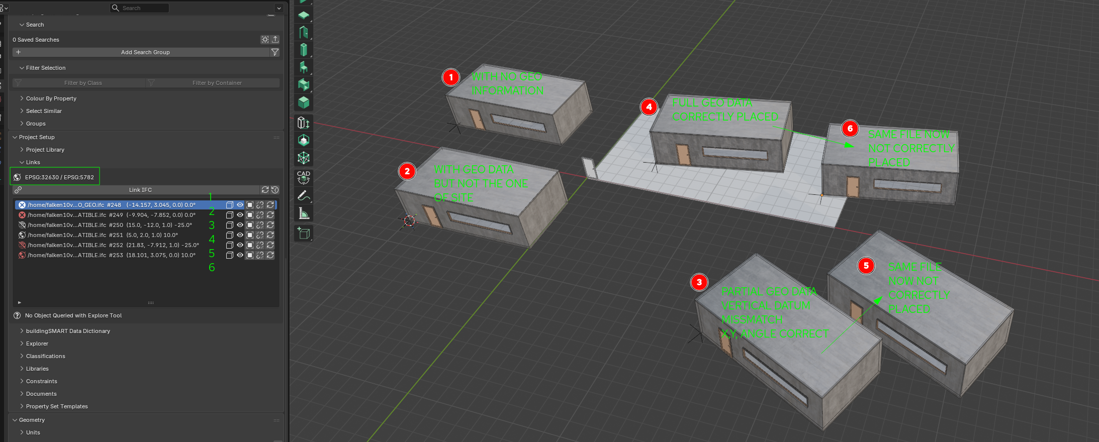

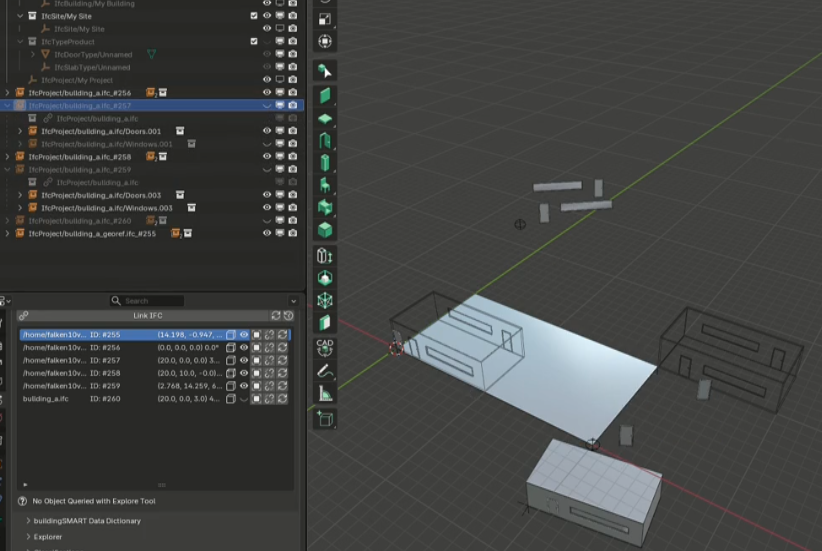

Since there are many combinations possible between the level of geo data in site.ifc and buildings.ifc. I have added the geo name and vertdatum in the link panel to know if the status of the site in terms of georefencing:
And then a number of icons to represent the different possibilities of the linked projects:
With no Geo data (white circle with X)
With incompatible geo data. That is. It has CRS.name and/or CRS.VertDatum but not the same as the ones of the site.ifc (red circle with X)
In this case, if you choose AUTOMATIC or DISABLED the effect is the same. You get it placed at the 3dCursor
With partial Geo data. That means CRS.Name is matched but not the CRS.VertDatum. In this case we can place it in X, Y, Angle but not Z (crossed world)
With full Geo data. We have a match for both CRS.Name and CRS.VertDatum. (world)
In this case AUTOMATIC will place them according to the geo data. And the placement will be right. However if you move them or create another instance in other place, we color the icons in red (alert) as the geo data in IFC does not match any longer the position here within the site.

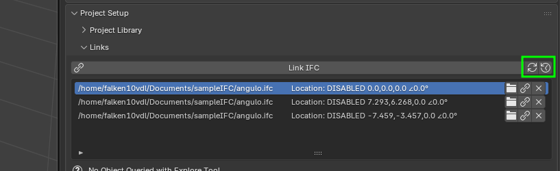

@theoryshaw said:
Also possible to have the links load automatically when opening the .ifc file?
Maybe this should only happen if there are cache files? otherwise it will take quite some time maybe to regenerate caches?
Please give it a try by regenerating caches in real world scenaria so you find if it makes sense to open (and eventually generate) the links when opening the .ifc file.

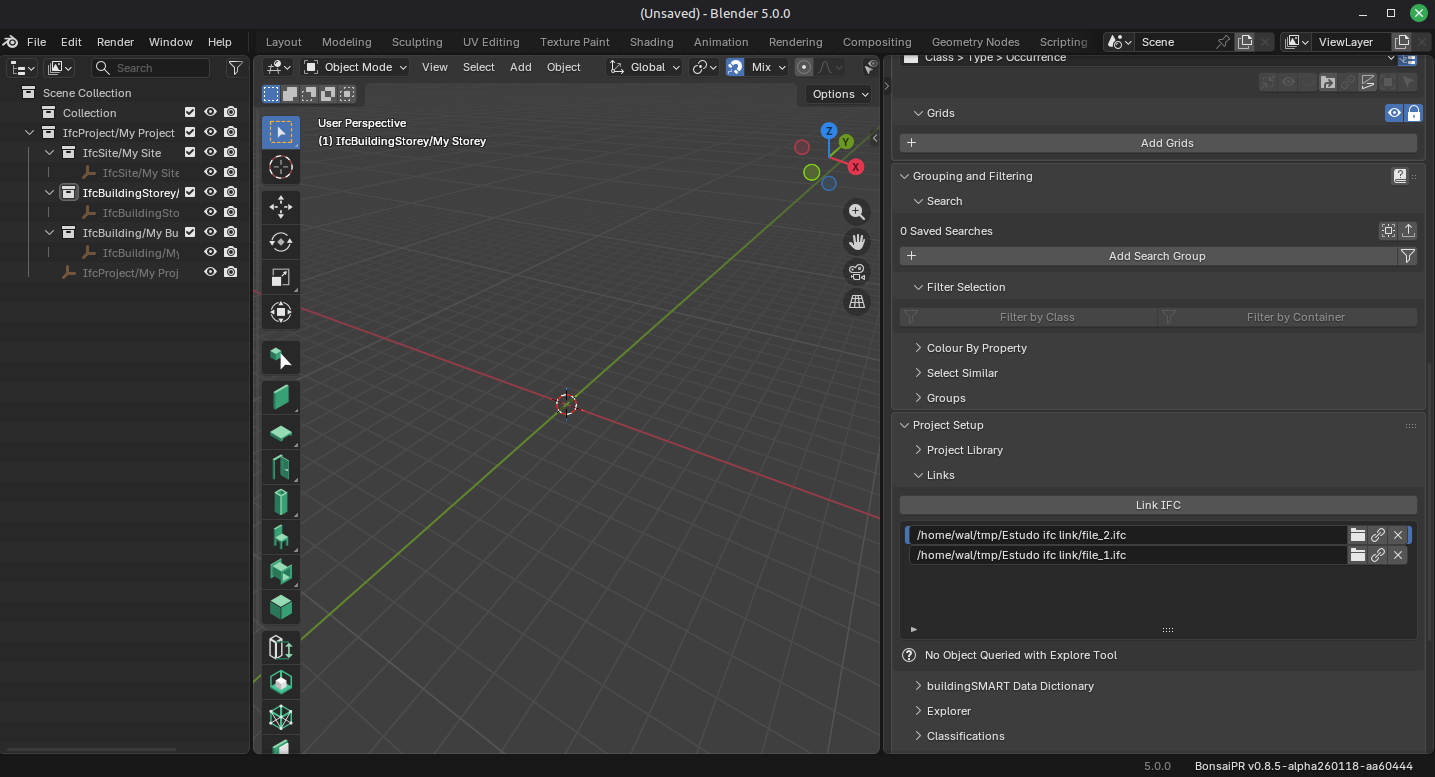

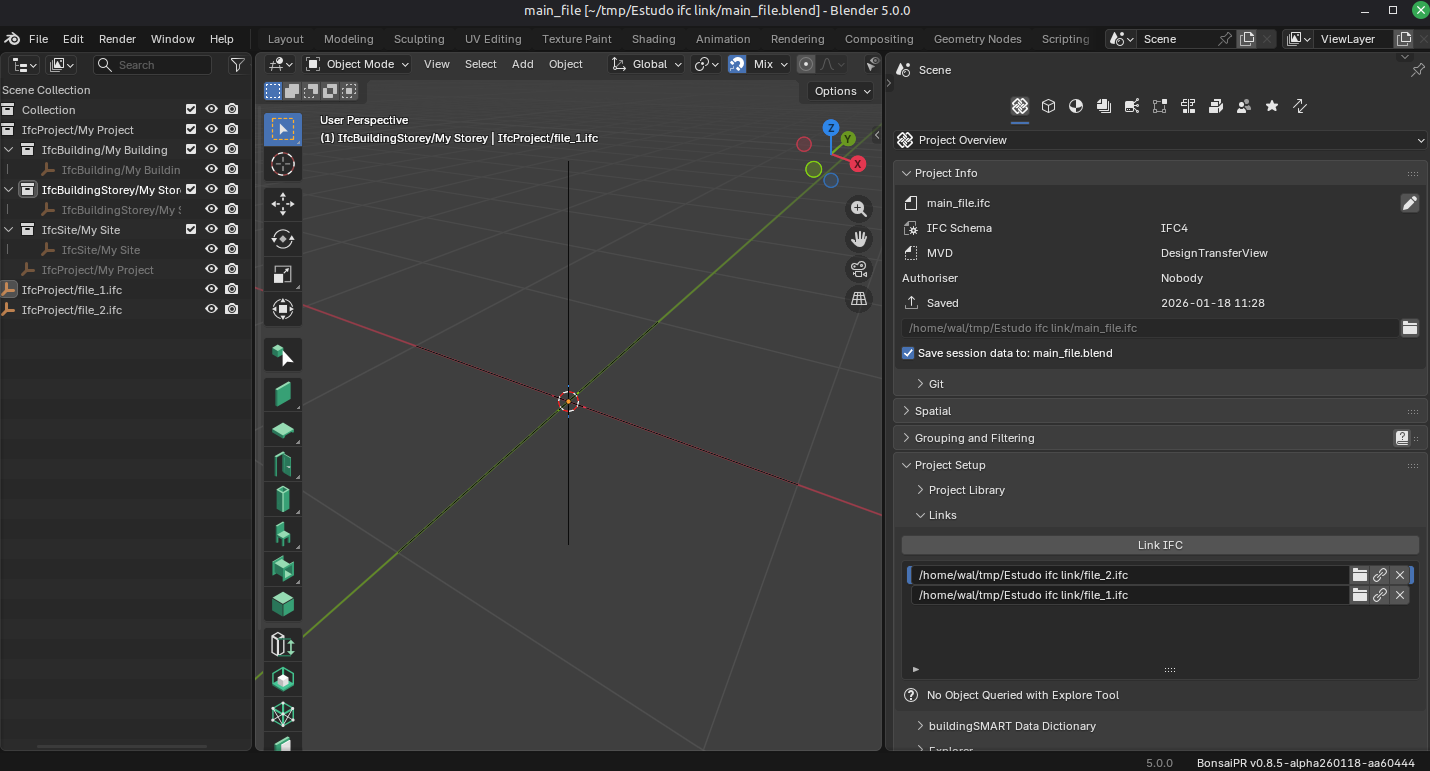

@walpa said:
Thanks @falken10vdl!

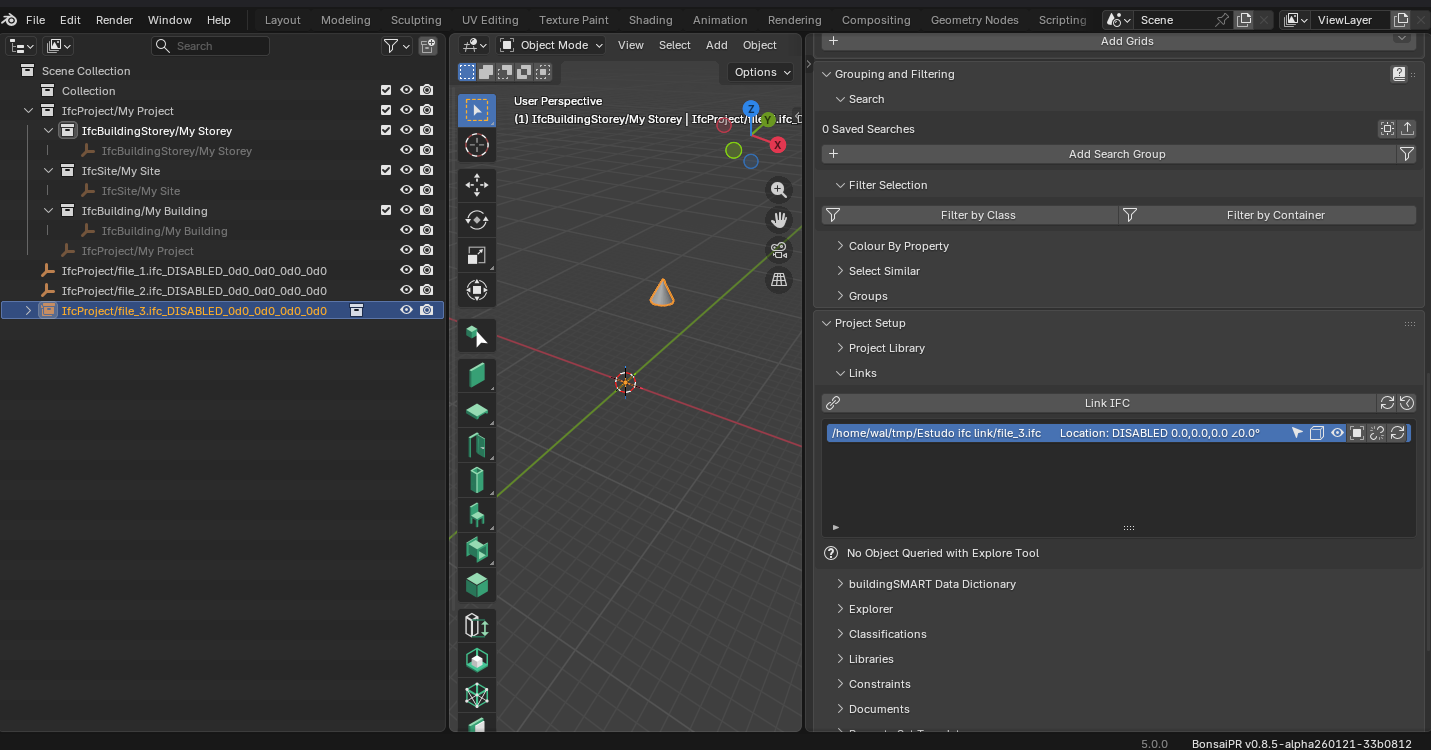

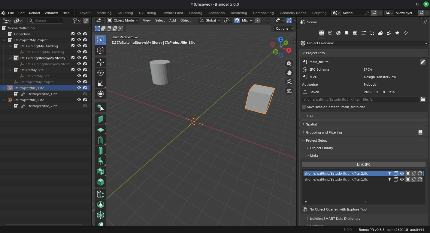

I'm not seeing the spatial structure and elements of the linked files in the outliner.
Is this feature not yet available? What am I missing?
Yes I think it has never been there. There is currently the possibility to go to the explorer tool and if you right click on an element, it will tell you the ifc data for it. It is reading the sqlite cache. Probably it would be interesting to agree what needs to be stored in that sqlite database and then how do we interrogate it from the UI. @Moult What are your thoughts on this? What makes sense? IMHO I like always the idea of LoD & "Divide et impera" :) Otherwise you need immense resources while in reality our brain can just concentrate in one thing at a time... I would say that double clicking in a linked project should open a new full blown blender+bonsai session with that file. So one can change whatever one needs and then when closing this session, trigger the cache regeneration for that particular file and update the corresponding instances in the parent site.ifc (- cpu + memory)
This is a great indicator of georeferencing status. My thoughts on linked file structure is that linked files are first for reference only, built for performance and scalability of massive files (which I work with daily personally). Other options should be possible, but without sacrificing the massive file support.
What else do you think needs to be done before the PR is ready for final testing and review? We can always have more PRs for additional feature after this :)

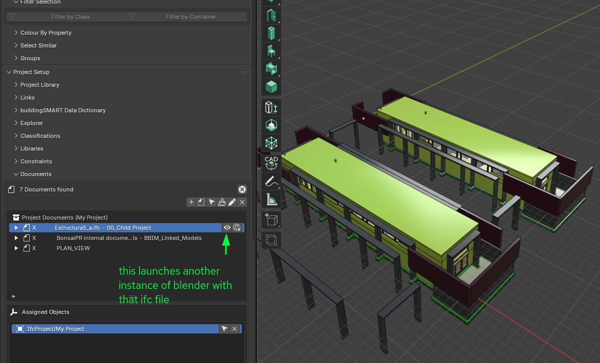

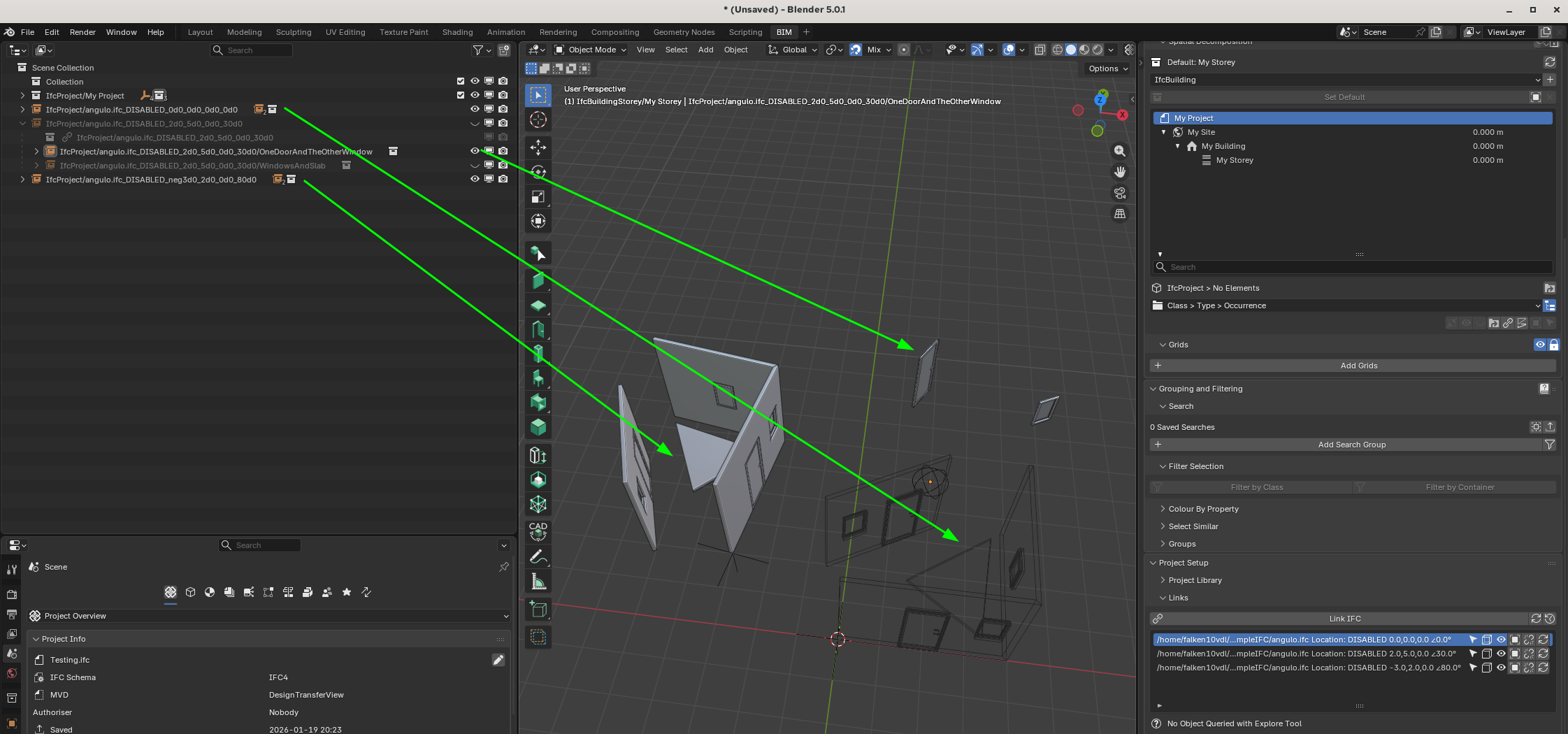

I think this sounds reasonable.
But it may be a problem on macOS. Usually you can't open another instance of an App.
Some Apps can open multiple Files inside an instance. Like Bricscad, Vectorworks, .... or even extract the extra files Viewports to another display. I would love if Blender could open multiple Files for drag and drop between both. Or like Modo that can show all open files at a time ....
I think there is an option/workaround. Unfortunately I lost the link to the tutorial, but I made an "App" by Apples Scripteditor that does open a second Blender instance, usually done by using Terminal. Should have been : do shell script "open -n /Applications/Blender.app"
Let me go over it and clean it and make sure all tests are passing.

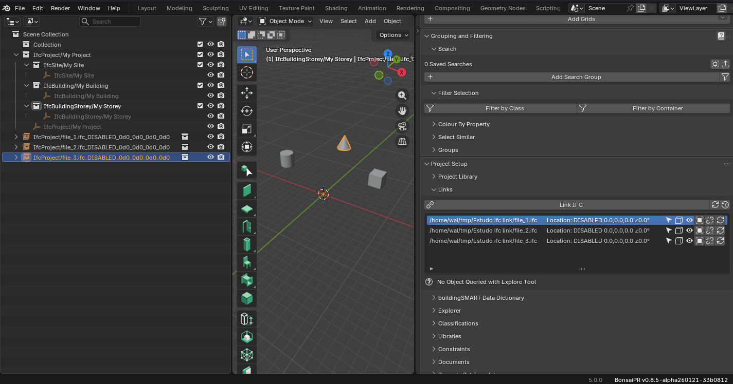

@walpa said: @falken10vdl
Regarding the visualization of the hierarchical structure, I understand that this is not the focus of this PR; let's leave that for another discussion.
I was just curious to know how you managed to make the linked file objects visible in the Outliner in your January 22nd video.
You mean the IfcGroups (just create a group in you building.ifc and you will see it in the site.ifc when you link it)? Well that was the origin of this thread but I was new to the workflow of linking files and when I started to play with them to see what the issue here was I saw that linking several times the same file was not supported so the conversation then shifted in that direction since that is a base requirement to have.

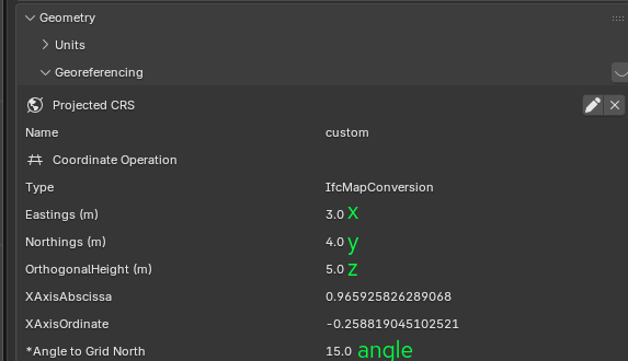

@theoryshaw but mirroring is not something that ifc handles with a ",switch" right? I mean. when we link a file we cache its blend chunk representation and then position it with location and angle. The ifc is the same for all of them.
In the case of mirror we can mirror in blender the chunk but the linked IFC is not represented but that file (the mirror in ifc is another file). We could store the mirroeing data in the doc reference (another field?) and generate the right postions

Also to clarify, mirroring is now possible

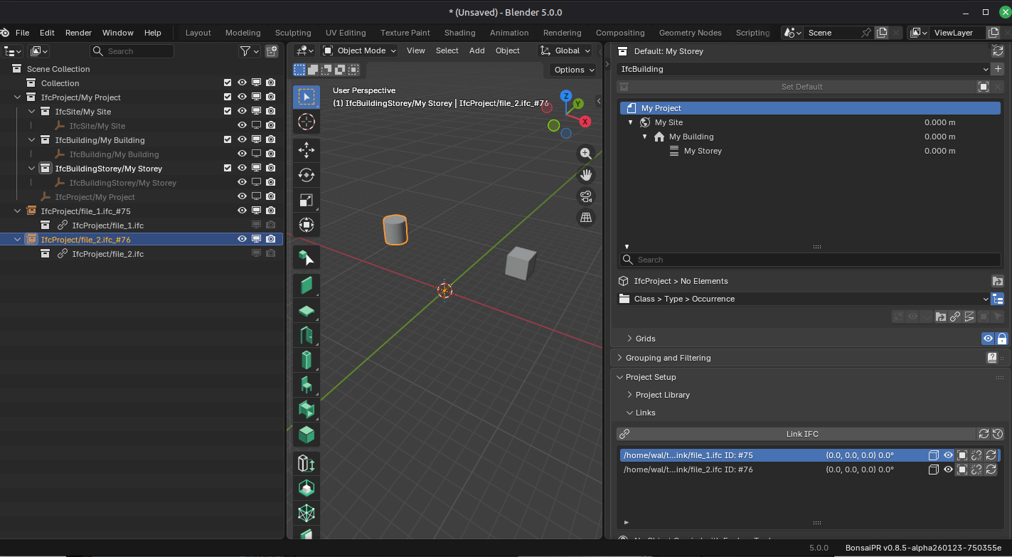

@falken10vdl
I tried several things but couldn't replicate it.
Thanks!
@Moult I have just created a PR with the main functionality for review.
https://github.com/IfcOpenShell/IfcOpenShell/pull/7607

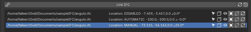

Thanks @falken10vdl for threading the needle! Not easy--community makes it easier.
@falken10vdl , would it be possible to support mirroring of these links as well?
Would help with laying out a site, for example, with one housing type that can be mirrored...
Similar to the 8 minute mark of the following tutorial video...
https://www.dropbox.com/scl/fi/ro9err44e8vhvw4sjdczd/129000_20250529_1627-Laying-out-the-site-with-housing-types.mp4?rlkey=8hj7cv1yaey5ojf4de2k9q438&dl=0
cheers?
Yes, support for mirroring in IFC is sadly lacking. :)
Yes mirroring the 'blender chuck' seems like the lowest hanging fruit.
Wow, really lots of argumentations in the forum you have linked... IMHO we can have some mirroring info (axis, global or local... etc.) the same way we have location and angle saved in the document reference and we just perform the mirroring in the blender 3Dview but do not create an IFC representation of the mirrored project. Is that acceptable?
Yes for sure!
Yes, creating a mirrored IFC representation would be pretty involved task i would think.

I would add double-click in a linked file opens that file, erases the cache and unlinks it. The idea is that if you want to change something in the original file you can just double click and it makes sense that you reload it then in the host file.
