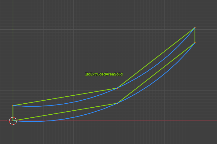

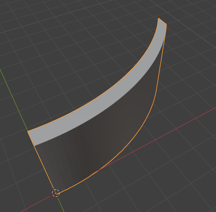

the closest you get to a curved wall, along with @sjb007 's advice, could be:
1. create a profile mimicking the footprint of the wall and extrude it into the z axis.
2. create a wall using Horizontal Layer and leverage the 3 point arc in CAD tool, this "preserves" the construction of the geometry
@steverugi Cool! I always forget about that three point curve tool. The one negative with it is that it does make you responsible for maintaining the consistent thickness of the wall.
