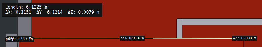

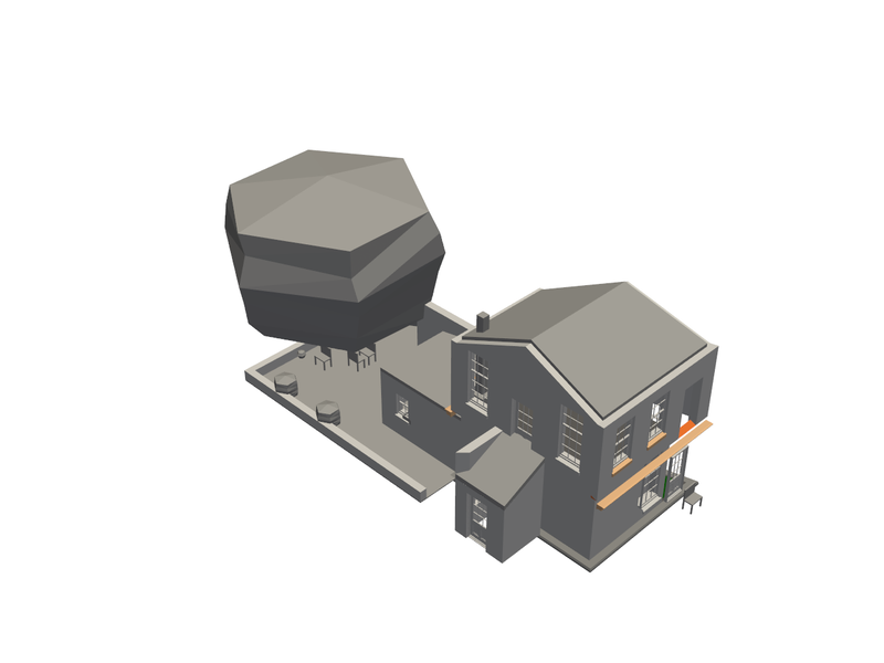

I noticed on the distance measuring tool I got garbled text on the line:
If I'm understanding what I'm seeing, the actual line length is overlaid by the delta in the orthogonal axis. Looks like some collision avoidance is needed for the text boxes.

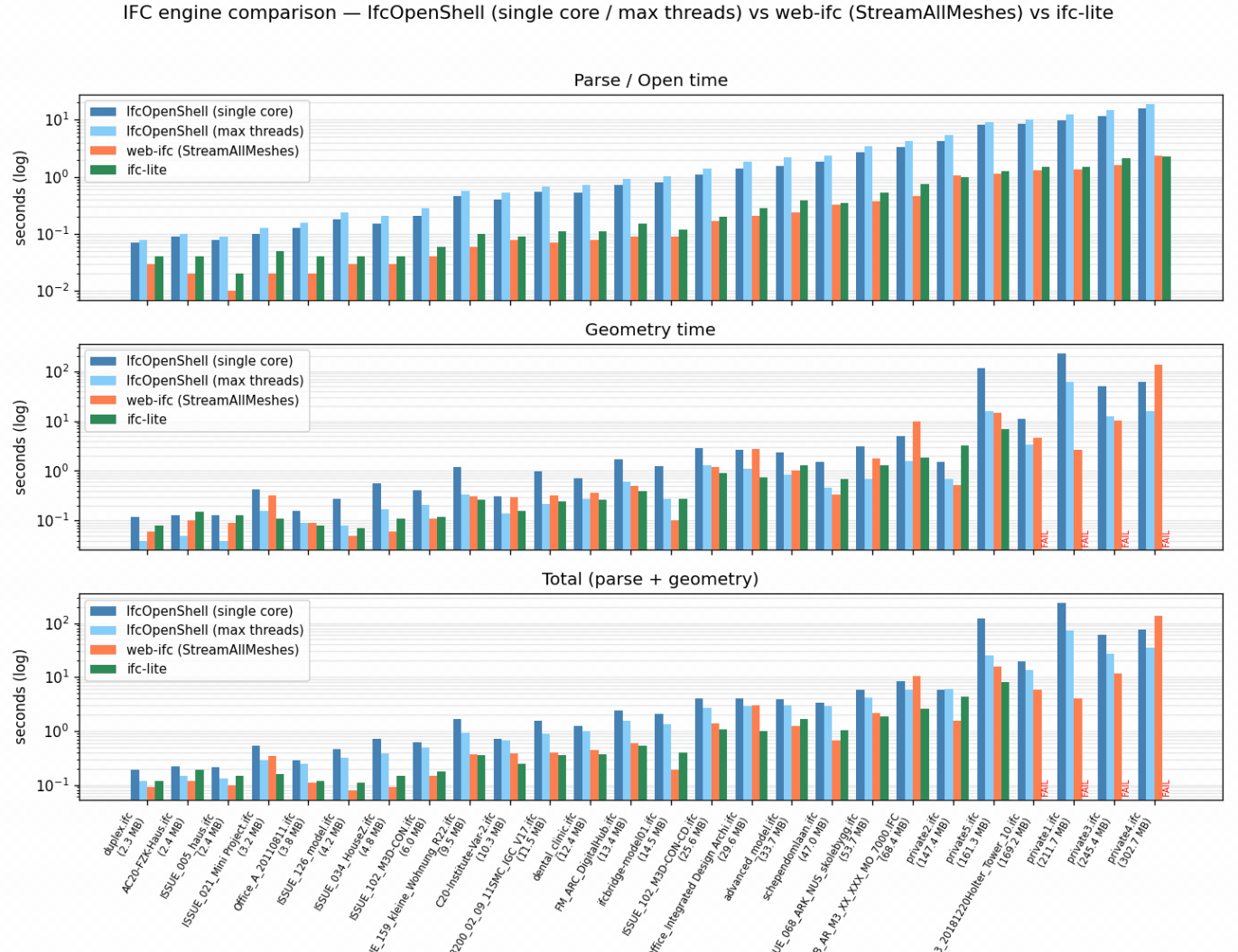

Is the initial loading of the IFC supposed to be faster than Bonsai? In most cases it is quite fast but I encountered a file, which takes 5 minutes to parse in Bonsai Viewer and it opens in 4 minute in Bonsai. Open IFC Viewer or BIMVision take less than minute to open this file.
The consequent cached opening is lightning fast.
@steverugi no refresh button unfortunately for local files (just manually delete). For cloud files there is a sync from cloud.
@semhustej it should always be faster than Bonsai, unless you've changed the geometry kernel. Unless it's to do with swept disk solids (e.g. rebar) where Bonsai has optimisations. When you say parse, there are two steps to loading: 1) a parse step, where you should see the progress bar present, but without a percentage, and 2) a geometry step, where the progress bar shows a percentage. Which step is slow, or is it combined?

The slow part is part 2 with progress bar with percentage. It is possible to see the building being built during this slow part. The percentage slowly rises, there is no obvious % where it would get halted.
There are no rebars in the model. There is IfcRailing in the model with round shape though (the vertical parts), but it's just a 4 story building.. When watching the building being built in viewer, the railing is flickering a lot.
I am using the default kernel both in Bonsai and Viewer.

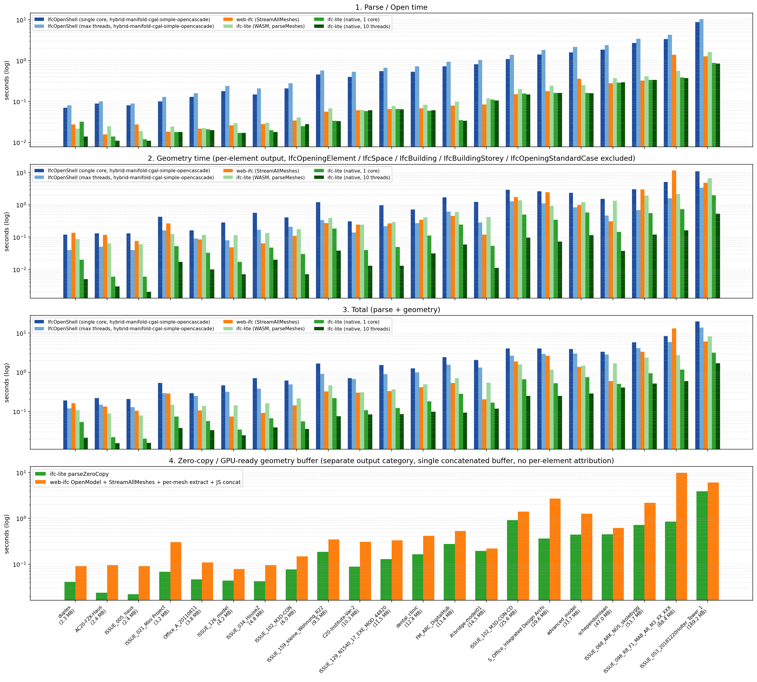

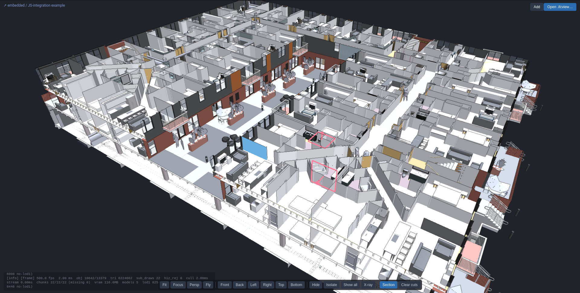

Viewer rebuilt with WebGPU. Expect either performance parity, or in some situations, 30% faster FPS. Maybe it was already seemed "fast enough", but trust me, we need to squeeze it on large projects.
Now cross platform! There is now support for Linux ARM64, and MacOS ARM64 too.

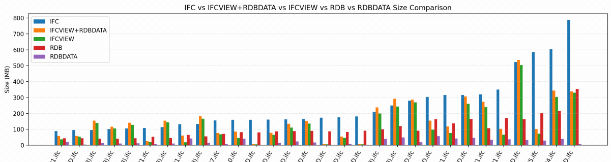

The IfcView format now supports compression, which means that it is significantly smaller. Before compression, I put 1.2GB of dense IFC data into ~700MB. After compression I put 2.7GB of IFC data into 260MB. This is really important because a main usecase is syncing data from a CDE. Downloading 1GB of data is slow for everyone. Downloading 260MB (18 models) is doable.
IfcView format now supports streaming and chunking. This means you don't need to load everything at once and it can scale depending on your VRAM.
Adaptive loading. Let's imagine you have a huge project. As things start streaming it, you can see enough to move around. When you move around, it only loads things you see. You can test this out in the link above and watching the progress bar change as you look in different directions (assuming you have a slow enough internet speed and it takes a while to download 20MB).
New web based control option LMB orbit, MMB pan, RMB select

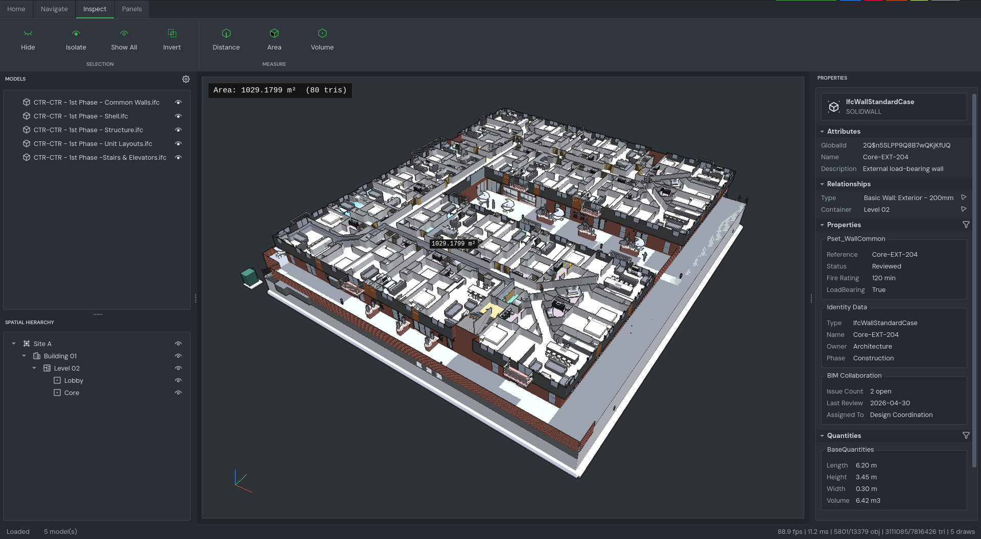

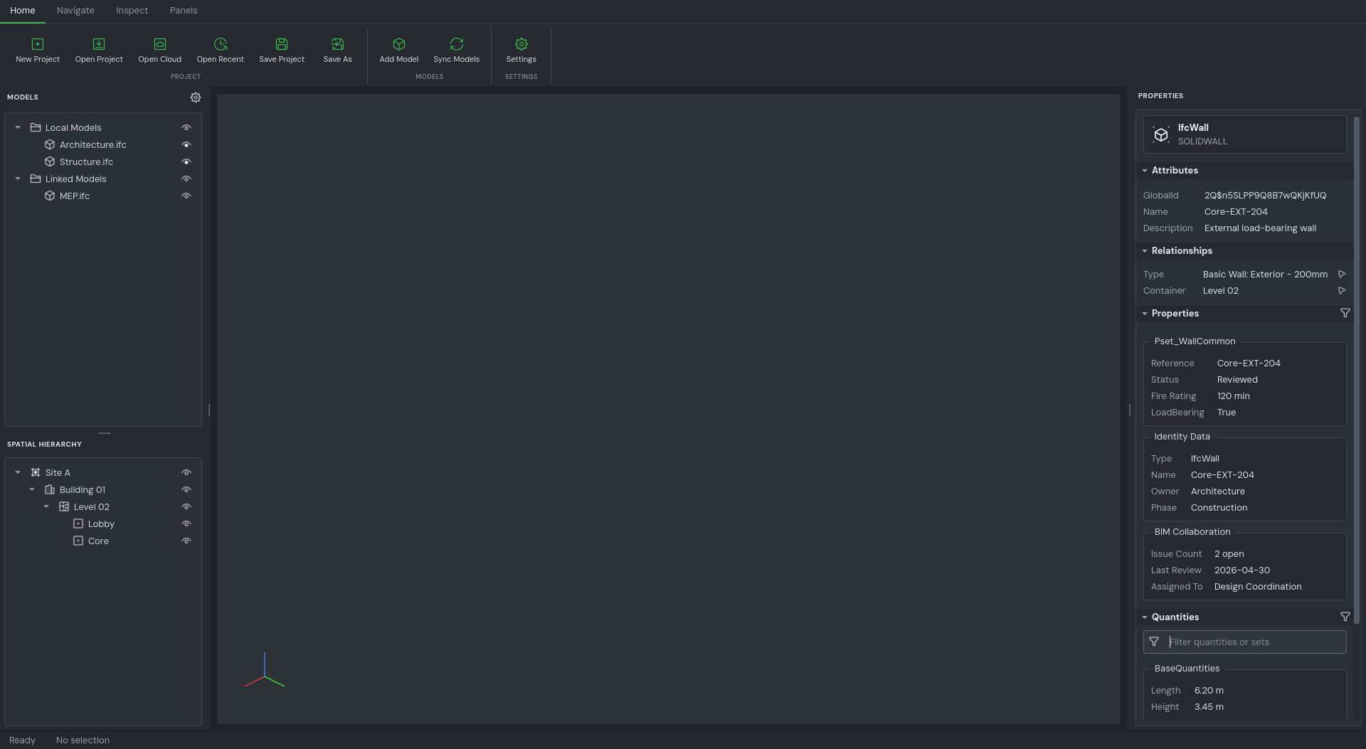

Desktop viewer now shows proper spatial data, attributes, relationships, properties, and quantities.
Support for transparent materials.
You can now add the RDBVIEW files (pick Add Geometry) as a model. This is the recommended workflow for coordination activities. You do not need full IFC data, it is super fast, memory efficient, small filesize, and almost lossless, apart from IfcRepresentationItem (i.e. semantic / parametric geometry). This is in contrast to say Fragments where it is drastically lossy.
Cloud plugin for Autodesk is rebuilt in Rust. This means instead of 25MB it is now 3.8MB.
Nav tips: select an object (RMB on web, LMB on desktop by default) and press f to focus. Use Shift-F to activate fly mode where movement is akin to a video game. Navigation is same as Blender - if you're comfortable in Blender, it'll click.

OK, tried it out even though I'm not the target demographic. I have one weedy personal model, but it certainly feels fast. That cached second opening! O_o I tried to blink but I missed it! The sectioning tool is so, so smoooooth too.

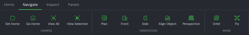

I know it's a WIP, so I don't want to jump the gun, but is the show/hide in the Spatial Hierarchy supposed to work already? The icon flips status, but everything is still visible.
I'm also wondering if you will be able to show/hide by EPSet_Status? While it's really easy to select and (h)ide something, it's not so easy to bring it back. I only have the Show All option.
