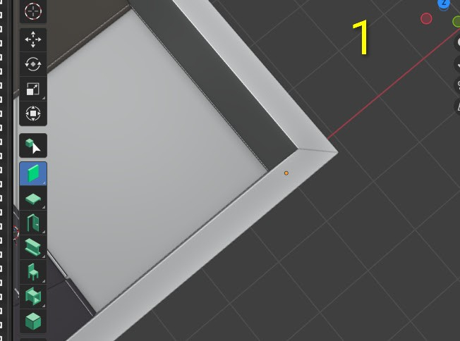

In image 1 you can see how the corner looks when it's correct — the walls meet cleanly.

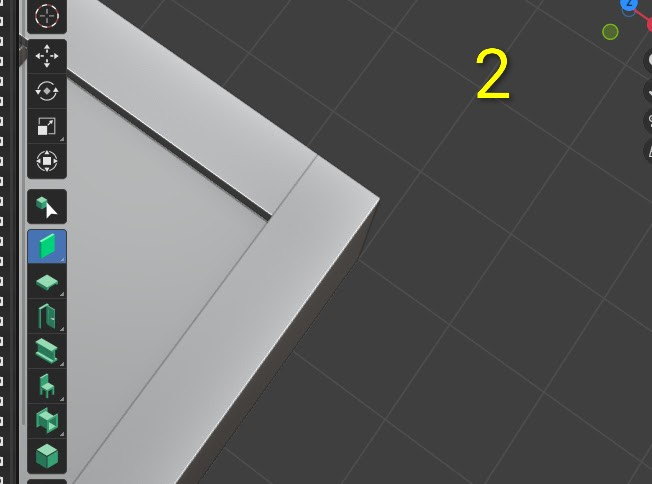

In image 2 you can see my problem — walls no is not aligning properly at the corner, doesn't join cleanly like in image 1.
I tried adjusting the corner with Shift+E but couldn't get it to align correctly like in image 1.
What is the correct workflow in Bonsai BIM to get a clean wall corner join like in image 1?

Did you try the Trim tool (Shift + T)?
@semhustej Thank you! Could you explain the exact steps for using the Trim tool? Which wall do I select first, and what exactly should I do after pressing Shift+T? Nothing happens when I try it.
@semhustej Never mind, I managed to fix it! The issue was a error in the wall itself, which was preventing the Trim tool from working. Once I fixed that, Shift+T worked perfectly. Thank you!
