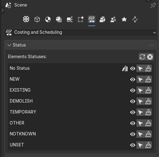

    I suspect you need two separate elements for that with their respective status, they can be turned on/off accordingly using a dedicated panel:
    BTW if you wonder why the Status panel is under Costing and Scheduling you are not alone ;)

  • Thanks @steverugi !
    I didn't' know about this menu, I was using the general properties panel
