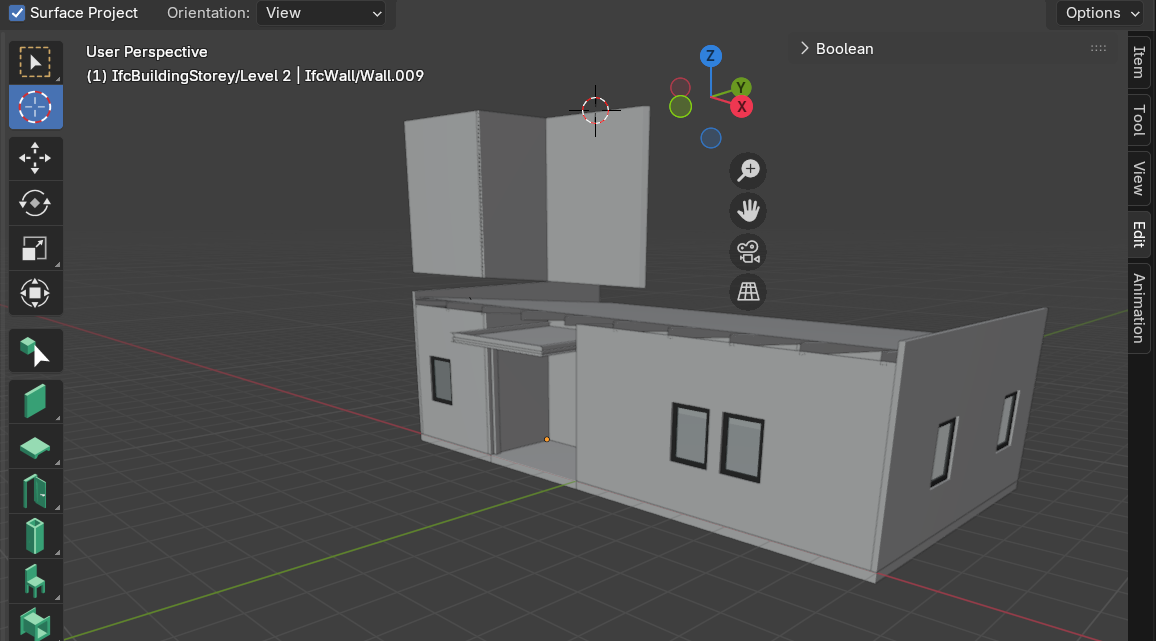

Tried to extend wall to the sloped slab, got visually trimmed wall.
I am new to Bonsai + Blender. I tried to model a room with a sloped wall attached to the slopped slab, I tried shift+E but there is a gap between the slab and the wall. Then I tried to extend the wall to the cursor, through the slab, around 7 meters high. Then there is a gap in the mid!
dle of the wall, with a shape of the slab. I guess it is the representation of the slab, that is visually trimming the wall. How can I fix this so that the wall is attached to the slab? Thank you.

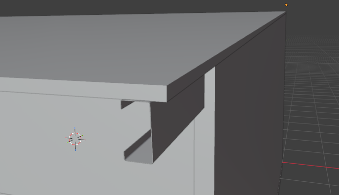

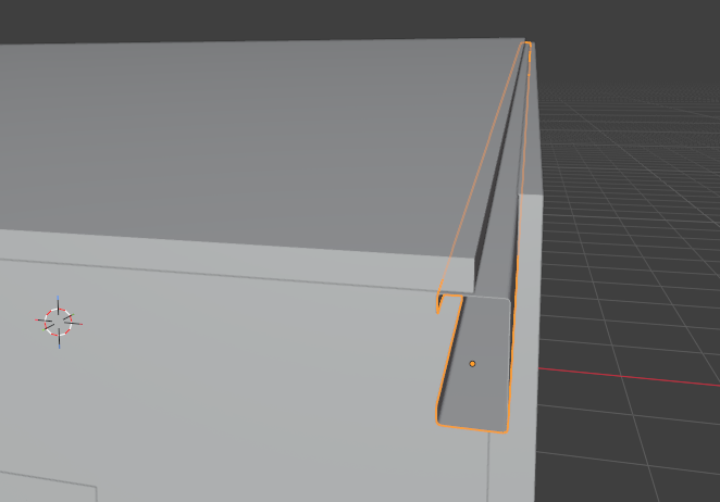

    I tried your model, the "gap" is the rafter I think which takes part of the wall, maybe try to extend the roof sloped slab on top of the wall to fix it.
    slab extended:
    now OK?
    cheers

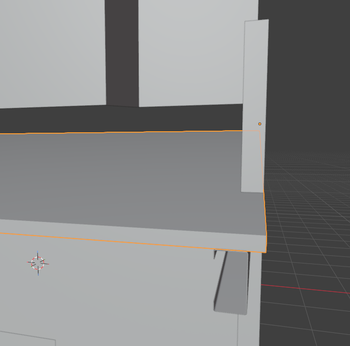

    Problem: can’t extend the wall to the sloped slab. Shift + E did not work. Python error log: select Level 2 and Level 2 objects.
    I used your very model and didn't have any error in extending the wall (shift+E with wall or multi object tool selected) up to the sloped slab, the wall is correctly cut on top, as I wrote earlier the slab cannot extend on it because it's defined by its 'polyline' or what you see when you edit it.
    Basically you can extrude/extend a wall (or a beam, column) but not a slab if defined by a horizontal layer (I think)
    I don't think the container is the issue, since I used your wall (ground floor) and floor sloped slab (Level 2), no problem.
