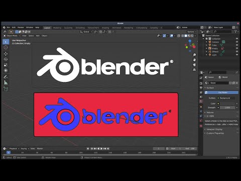

Heads up, blender will embed potrace for grease pencil soon (2.91) maybe this will help in getting vectors from pixels - don't know if a trace api will be exposed for addons.
Perhaps the 3d to 2d tool of grease pencil may be an option ?

I assume this is what you were talking about?
This is about potrace
