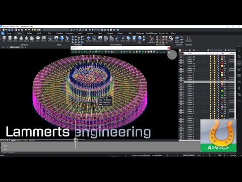

I wanted to include a youtube demo on the wiki page about DWG and IFC.
Wiki does not to be supporting this yet. Is it possible to activate this feature on the wiki?
Here is my working with IFC in DWG :) The Lisps are totally open source coding.
Just google them
9EFVV-azs8k
@magicalcloud_75 thanks! This extension is now installed and your video is now showing! Thanks for the contribution!
