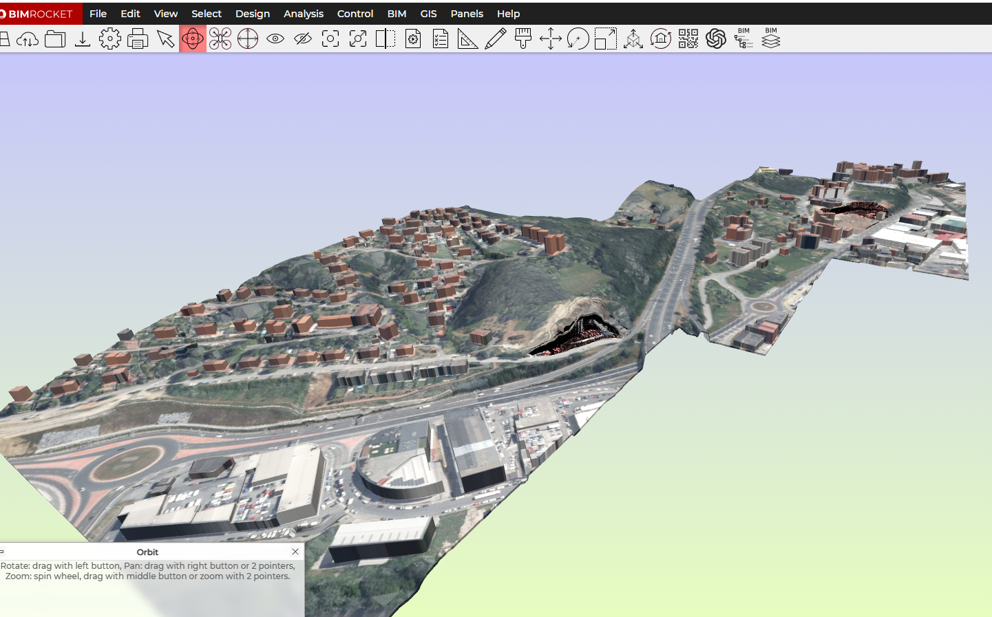

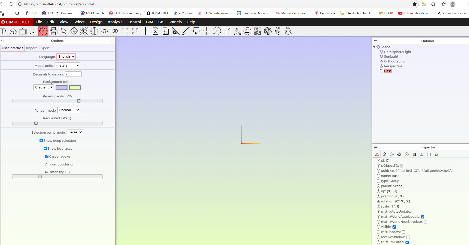

A very useful free viewer that can federate models, inspect and edit them. It also supports the insertion of GLB files (for terrains with orthophotos), and it can be customized if you have programming skills, as all the information and source code are available on GitHub. https://bim.santfeliu.cat/bimrocket/app.html
