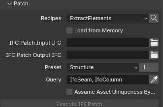

I think there is an IfcPatch recipe just for this, I can't show a screenshot right now though.

Yeah so the Migrate IFC patch does a pretty swell job at upgrading IFC2X3 to IFC4 (specify
["IFC4"]
as an argument). However, although in theory it can downgrade, it would likely fail on a real project (it'll work for small subsets of data, though). This is because I never wrote the code to handle downgrading certain IFC4 geometry types since I never needed it and it was more urgent to upgrade than downgrade.But let me know if you need downgrading and I can find a bit of time to implement it. It's pretty straightforward, just another item in the endless todo list.
What's pretty awesome too is that in the latest BlenderBIM Add-on builds since this is such a common thing, there is now a one-button upgrade whilst you're loading files:
