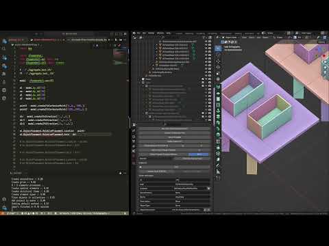

Is the workflow you used to model IfcElementAssemblyType the same as IfcElementAssembly?
How did you instantiate IfcElementAssemblyType? Did you use BimTool?
Please post a video showing how you did it.
Thanks

Unfortunately, there is no way to achieve it through the UI (at least, I didn’t come with any).
So everything is done through Python-scripting. Rather messy one, to be fair.
I’ve prepared small IFC-file through BBIM, which have usual template stuff and three types of physical objects (IfcPlateType for sheets, IfcBuildingElementPartType for insulation and IfcSlabType for concrete base).
Everything else is made through the algorithm:
1. Create physical instances of 5 IfcPlates (sheets);
2. Assign them representations;
3. Assign them IfcPlateType;
4. Assign them spatial container (IfcBuildingStorey);
5. Create local placement for them relative to the container;
6. Adjust their local placements to make box-like model out of them;
7. Repeat for 1 IfcBuildingElementPart (insulation);
8. Create IfcElementAssemblyType which will typify sub-assemblies;
9. Aggregate all 6 physical instances with just created IfcElementAssemblyType through custom "aggregate_assign_object" function (as dumb as possible);
10. Create instances of 2 IfcElementAssembly (sub-assemblies);
11. Assign them the IfcElementAssemblyType;
12. Assign them spatial container (IfcBuildingStorey);
13. Create local placement for them relative to the container;
14. Use recursive function "copyPartsFromType" which take all the instantiated objects that decompose the type (and relating objects in recursion), shallow copies them, assigns Relating Object to each copy through custom function mimicking the "assign_type", then aggregates them into corresponding sub-assembly, and finally makes the local placement of sub-assembly as the reference placement for each copy;
15. Adjust the local placements of the sub-assemblies;
16. Create IfcSlab (concrete base) and everything that comes after as with IfcPlates;
17. Then repeat the process for several main assemblies with assigning sub-assemblies and the slab to a main assembly type, instantiating it and RelDefiningByObject all its content through recursion.
18. Flush the model into a file.
As I said, messy. Hope it somehow helps…

some contribution ;)
Thanks for sharing python file.
