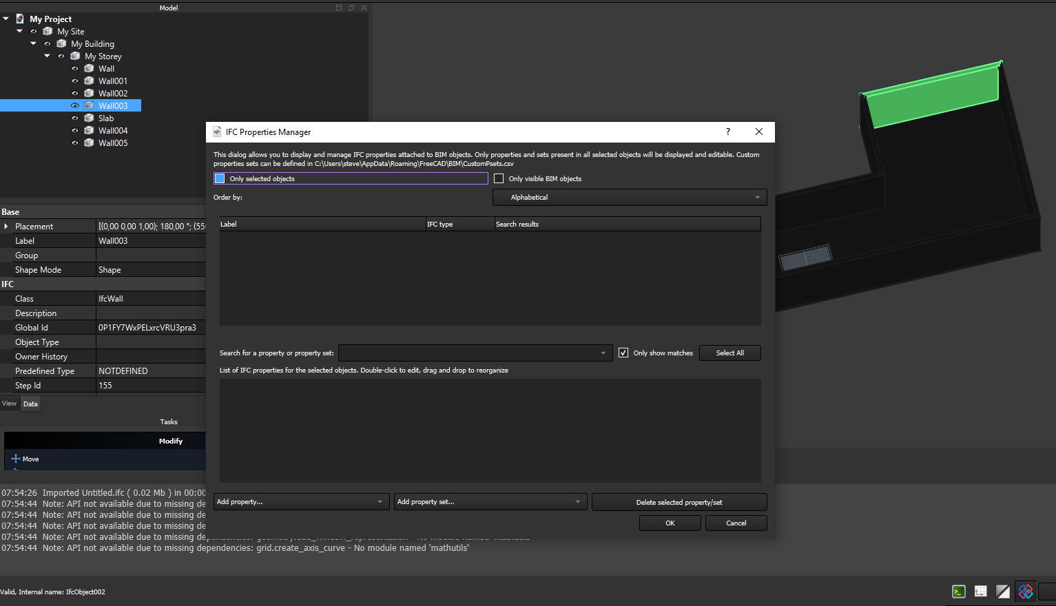

Hi there, I am trying to get my feet wet with FC1.0
importing a IFC4 model I can't show elements to see their properties in the panel
any help would be very appreciated, thanks in advance

Hi,
I did a test with FreeCAD 1.0 and I can reproduce the bug of FreeCAD not showing IFC properties in the 'Manage IFC Properties' dialogue.

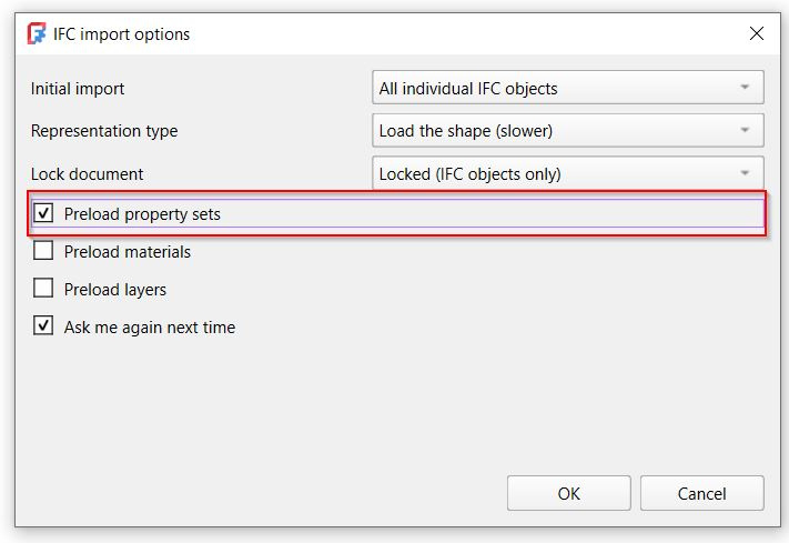

if you plan to work with IFC properties in FreeCAD, I recommend to use 'Preload Property Sets' when opening the IFC file. This loads all property sets. Otherwise you have to double click an object in the Project Tree to be able to access the property sets.
for small file I also recommend setting 'All Individual IFC objects' and 'Load the Shape' too
