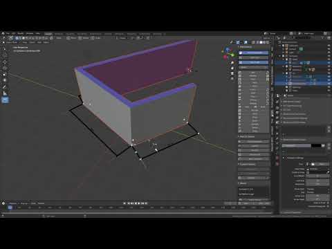

MeasureIt Arch compatibility will land in archipack 2.3.1
Get best of both worlds, manipulable with real time update, single click to add "measured points", global style.
