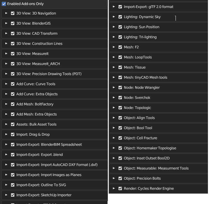

  • these are enabled add-ons
  • @Nigel it isn't likely to be any of the addons that come with blender, which of these have you downloaded?

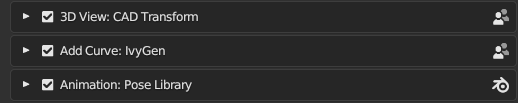

  • I believe The little person icon is a community addon and the blender Icon is a blender default addon
    So deactivate the person icon addons
    But yes it would be easier perhaps to reinstall / get a different version of blender
