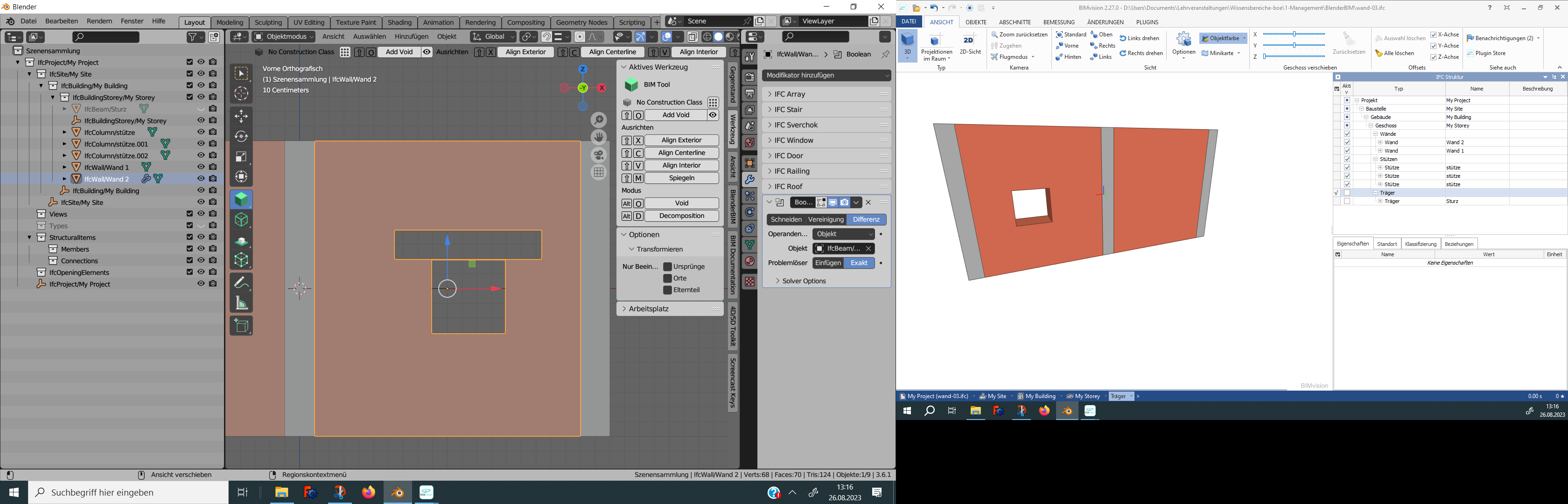

At the moment I don't think so since ifc & Blenderbim uses a different boolean system,
A workaround would be to create an ifcOpening that you model around the shape of the beam interesection, but this is not dynamic nor time efficient.
Maybe put it as a feature request on the Github page? Sounds useful to me https://github.com/IfcOpenShell/IfcOpenShell/issues
From your screenshot, You would like to use the beam as a lintel? If I understand correctly, is it not more convenient to model the lintel/beam in the IfcWindowType itself? Or make an IfcElementAssembly with a Beam and Window? Please ignore this post if that was not your intention.
@Coen
I try :-)
+1, this feature.
@peterpaul
