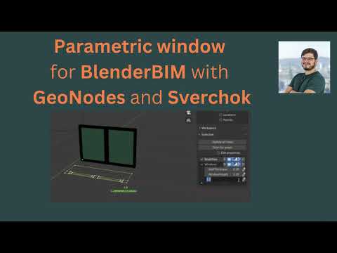

  • Just a parametric window for BlenderBIM with Sverchok and Geometry Nodes - proof of concept
    ? Is automation design a time saver?
    ? Is automation design helpful for repetitive tasks?
    ? Can you automate with free and open-source tools?
    I watched Lloyd Bussio the IFC Architect Video tutorial about creating a window for BlenderBIM in 10 minutes.
    Cool stuff! The link is here:
    For some reason it got me intrigued.
    So I started to replicate the tutorial using Sverchok and Geometry Nodes.
    ? Sverchok for the 2D representation of the window;
    ? GeoNodes for the 3D element.
    It was a good exercise to test my discovery - how to control the input for the Geometry Node script with Python code using Sverchok.
    Well, the results are in this video. Good enough for a proof of concept.
    I even loaded the new ifcWindow Created into an ifcWall.
    bruno_perdigaoAcesteverugiNigelBedsonatomkarincabitacovirGerardT

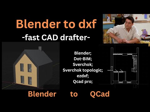

  • Build annotated 2D CAD drawings from your BIM 3D ifc model. Wait, what?!
    I flooded LinkedIn with this idea - that you should be able to generate 2D drawings from 3D IFC models complete with layering, line types, hatches, and annotations as easily as you generate a graph in Excel.
    It is easy to say. But how about doing it and showing it?
    Had to give it a try and record the process.
    Just take a look:
    So it turns out with some python code in Blender you can:
    👉 create a ifc column with ifcopenshell python and make it purple;
    Link to the code:
    Obim.ro
    And using the same input with ezdxf library to generate in a dxf file:

    Imagine a second viewer tab for Blender that shows the 2D representation of your ifc model in dxf format (or svg).
    Work in progress. (The dxf file has also the dimensions and lineweight, still need to configure the viewer).
    It is possible to configure also different styles or uses (for example formwork plan with specific notation, TOV reinforcement plan and so on).
    JohnsteverugiAceGorgious
