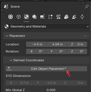

  • @Kieran This looks like a bug where the extension function is using the original vertices of the wall segment. The transform you applied to the walls doesn't automatically get "applied" to the Ifc model in effect. You can fix this by clicking the "Edit Object Placement" button here:
    The little asterisk I've pointed to appears after you move the walls, and indicates that there is a difference.
    So maybe this is intentional, or maybe the code should account for previous transforms automatically. I'm not sure.

  • Thank you @sjb007 That worked perfectly as you explained.
    Does that me that the 'Edit Object Placment' needs manually updating everytime an object is moved around?

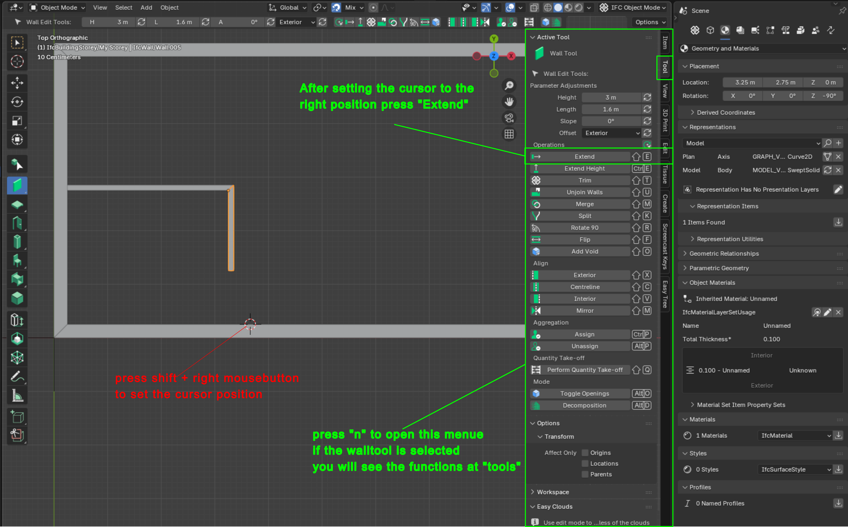

    @Kieran You can also try another workflow... take a look at the picture...
    Or if the 2 innerwalls having a gap (like at the end of your vid) select both (shift +click) and press the "trimbutton"
  • edited September 2025
    @Mas Did you "G" grab and move the dog-leg walls before doing the extend like in Kieran's video? That is the thing that causes the odd behaviour when extending.
    @Kieran I can't answer that at the moment with 100% certainty. I haven't been doing a lot of work in Bonsai, but I don't remember having to click that button. It might be new(-ish) behaviour introduced for some reason. I know that if I add a demo bunny and move it, it also shows the asterisk. But if I save and reload, the bunny keeps its new position. I suspect this is specific to particular object types and operators.
