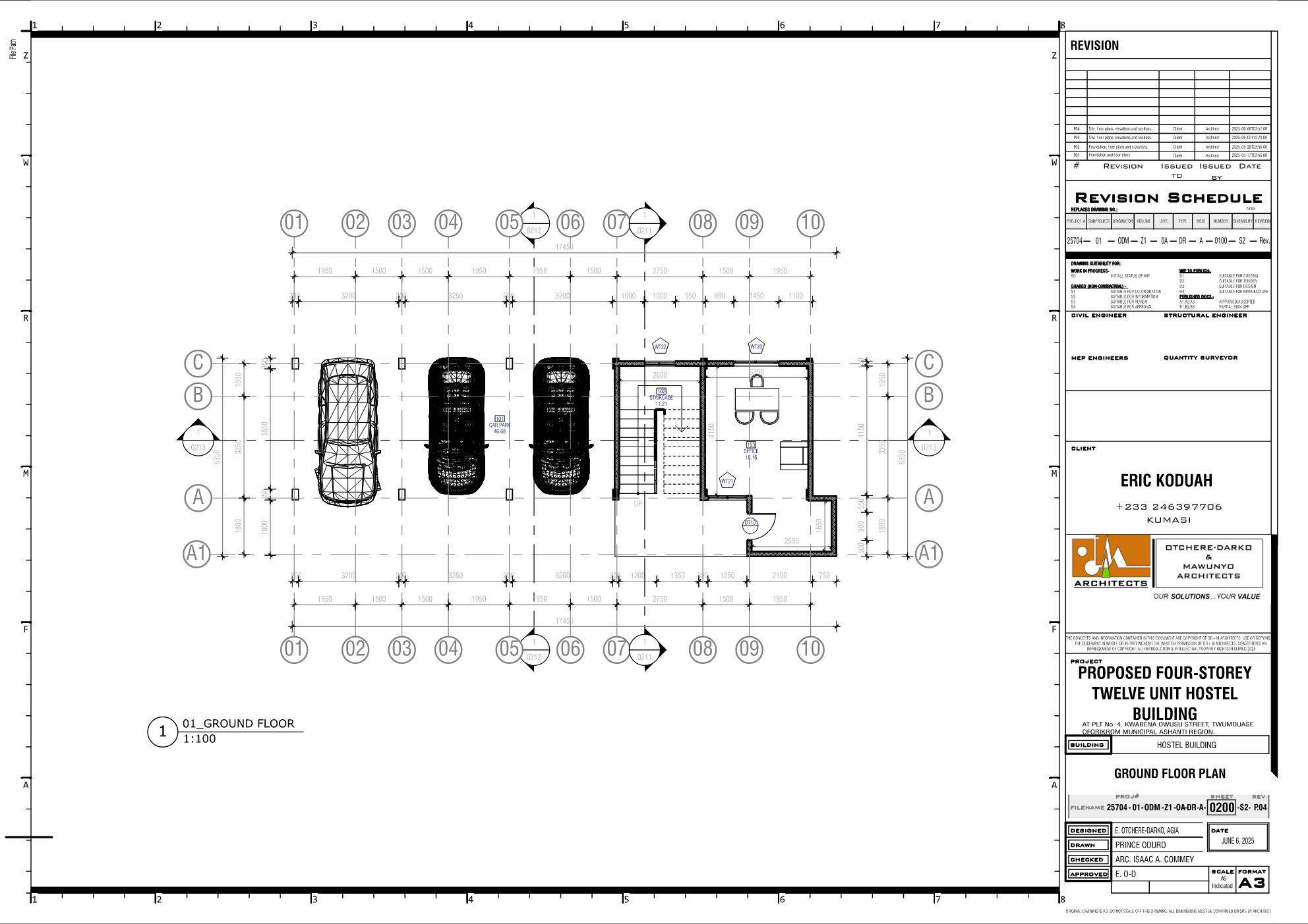

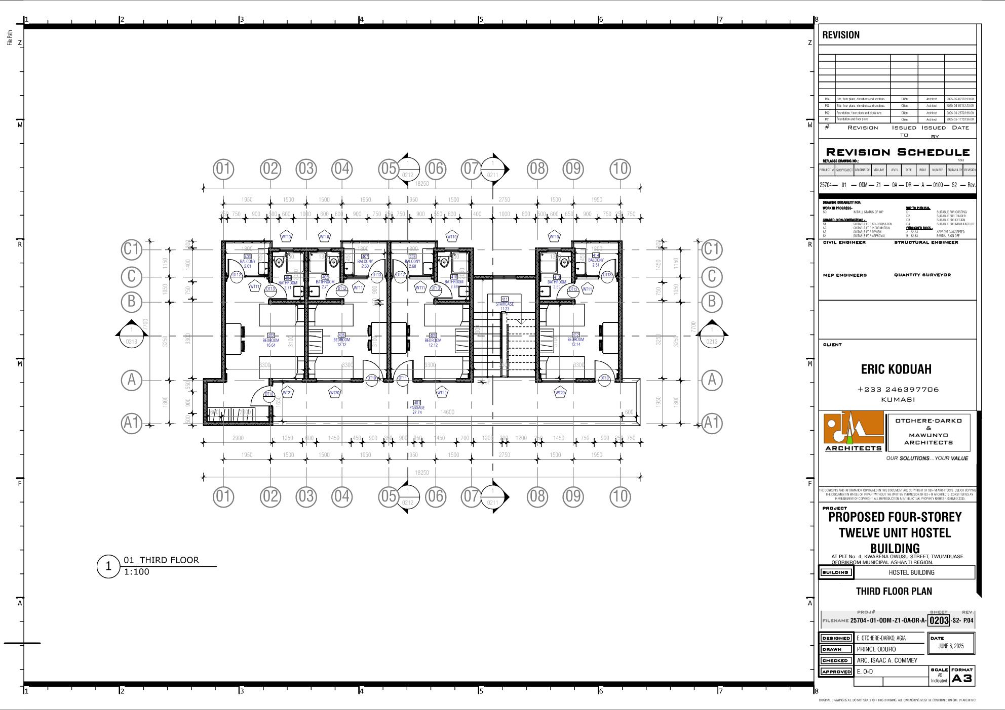

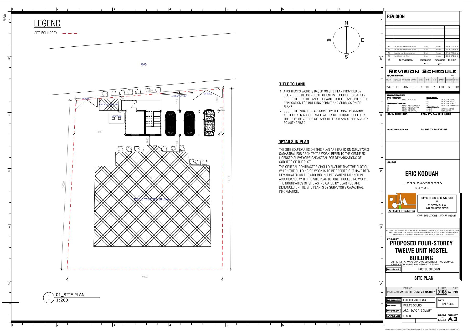

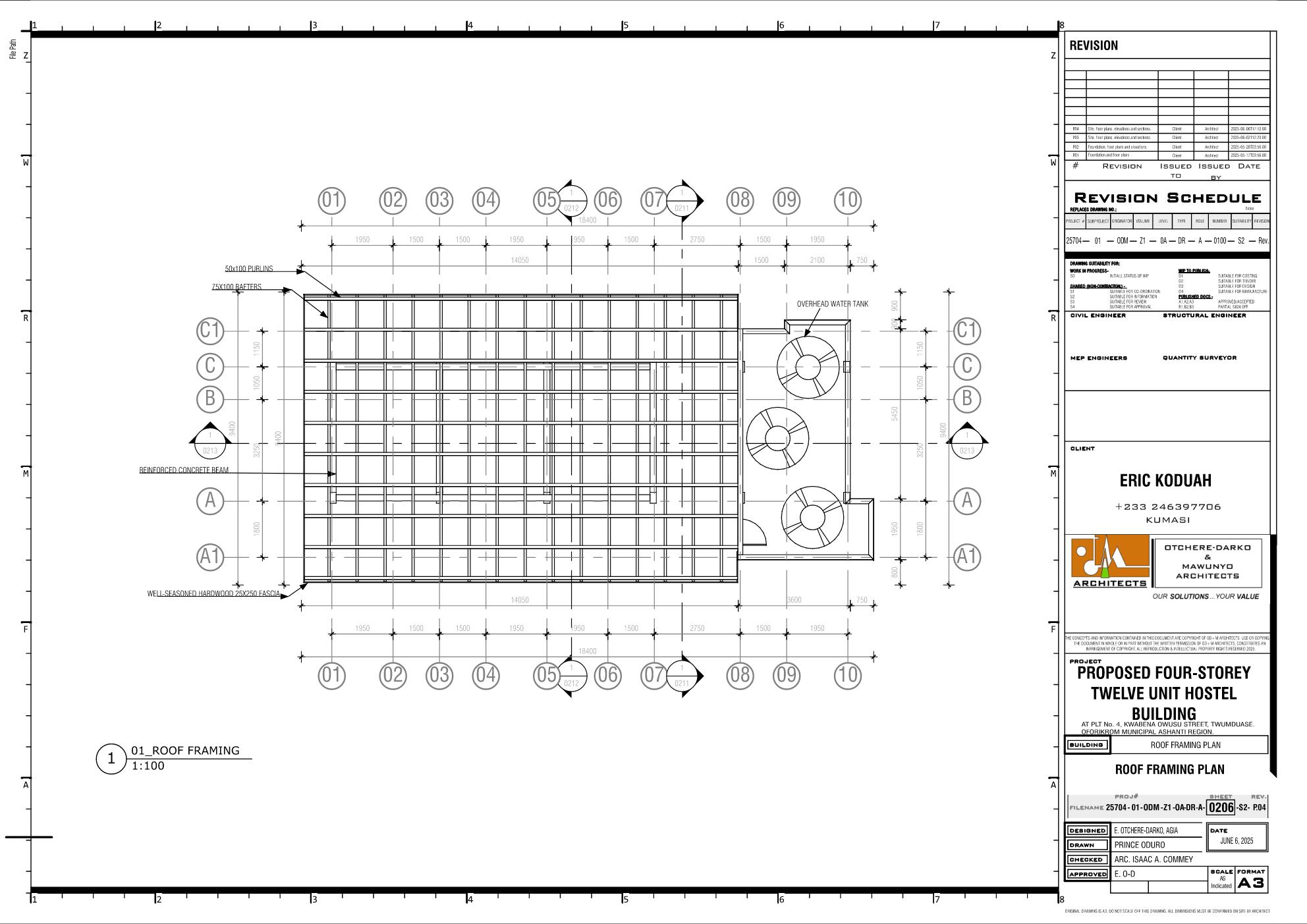

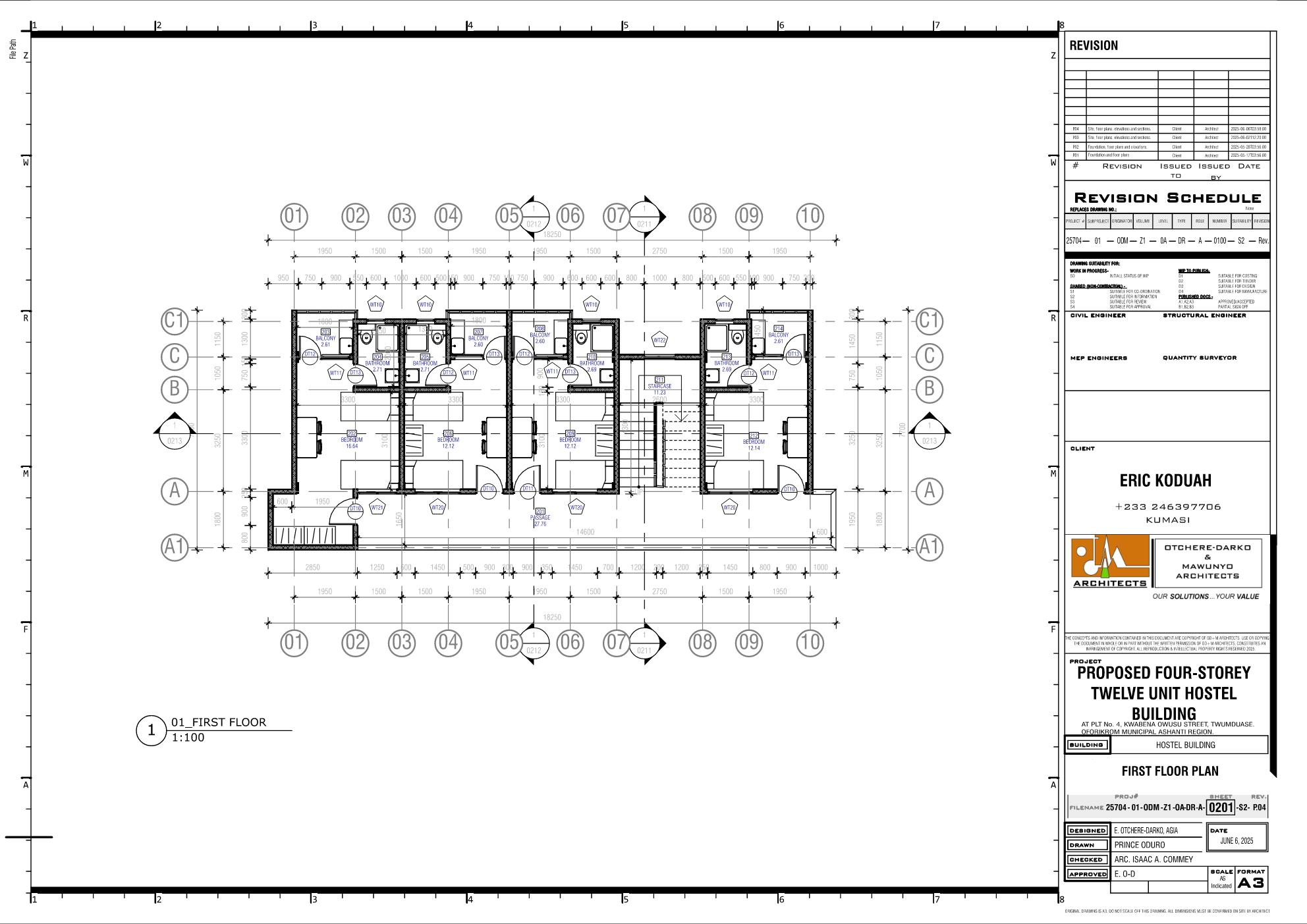

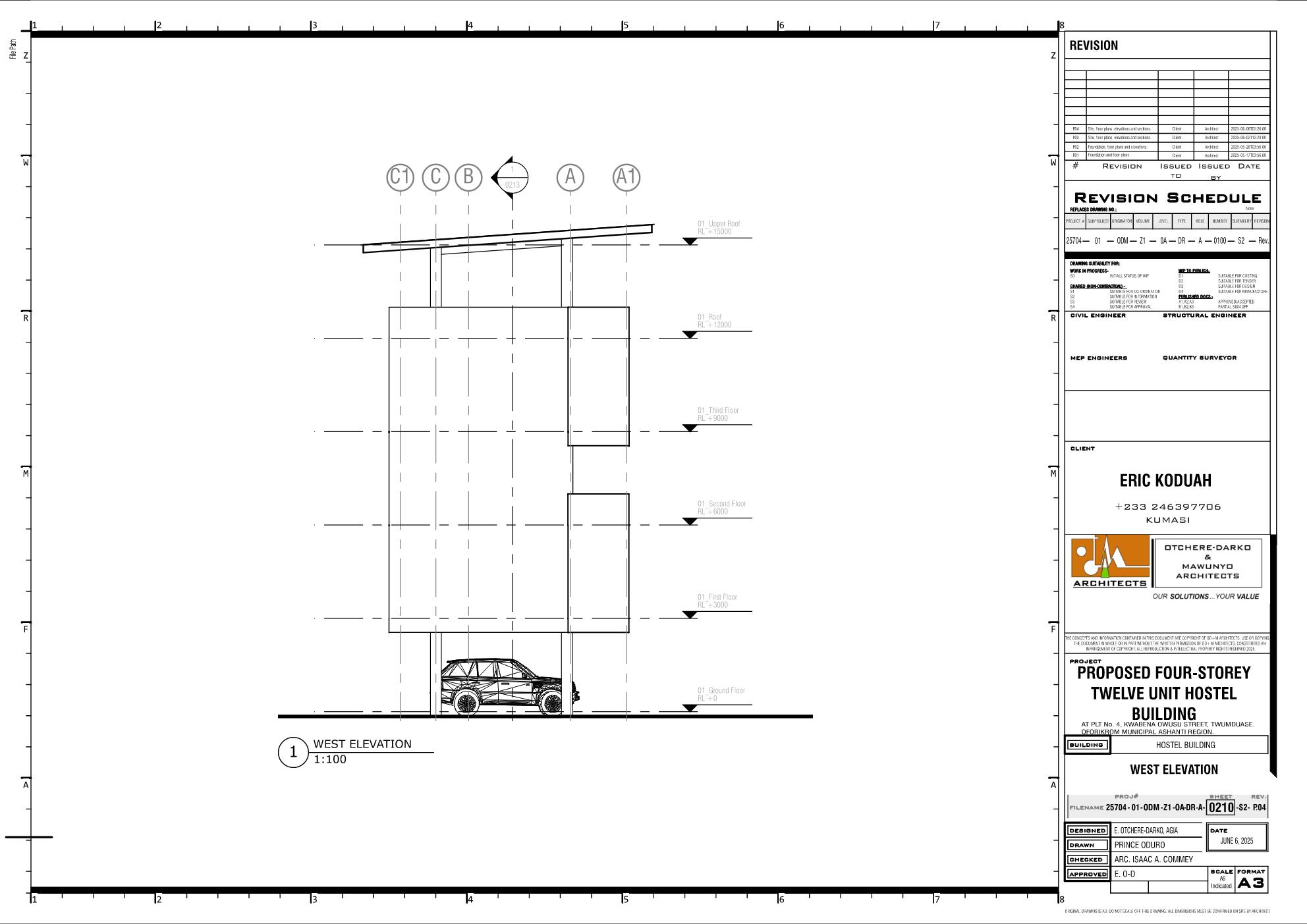

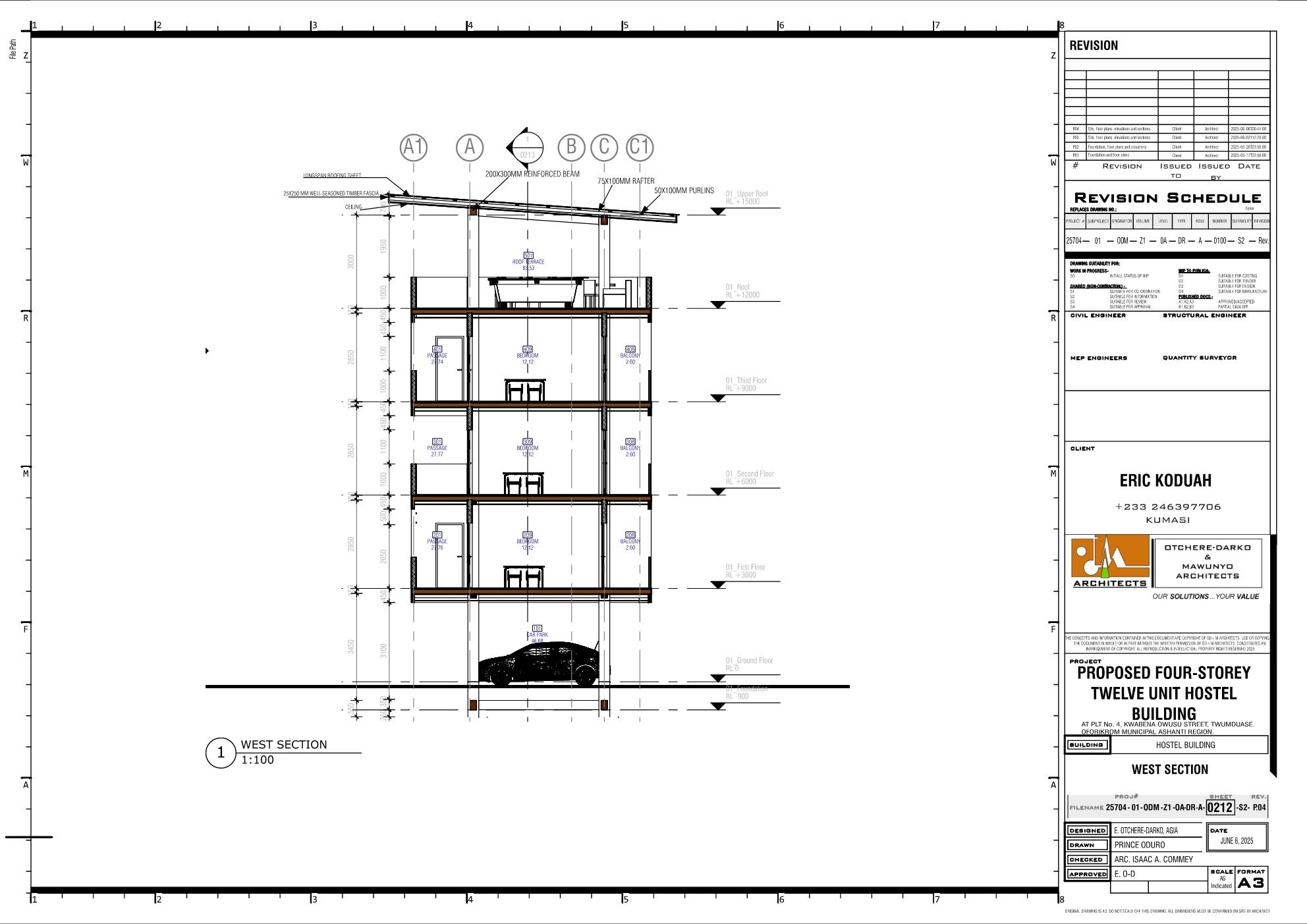

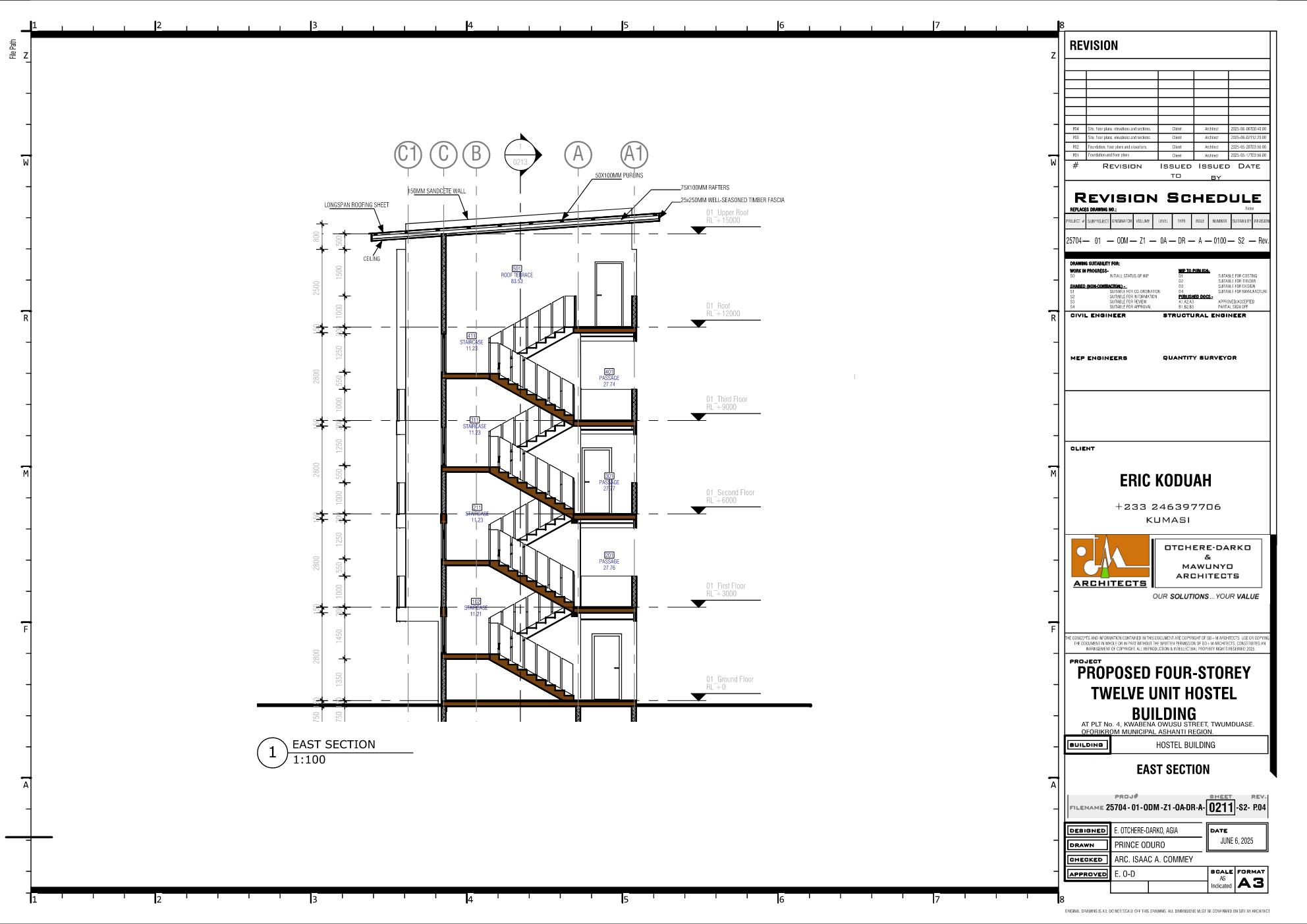

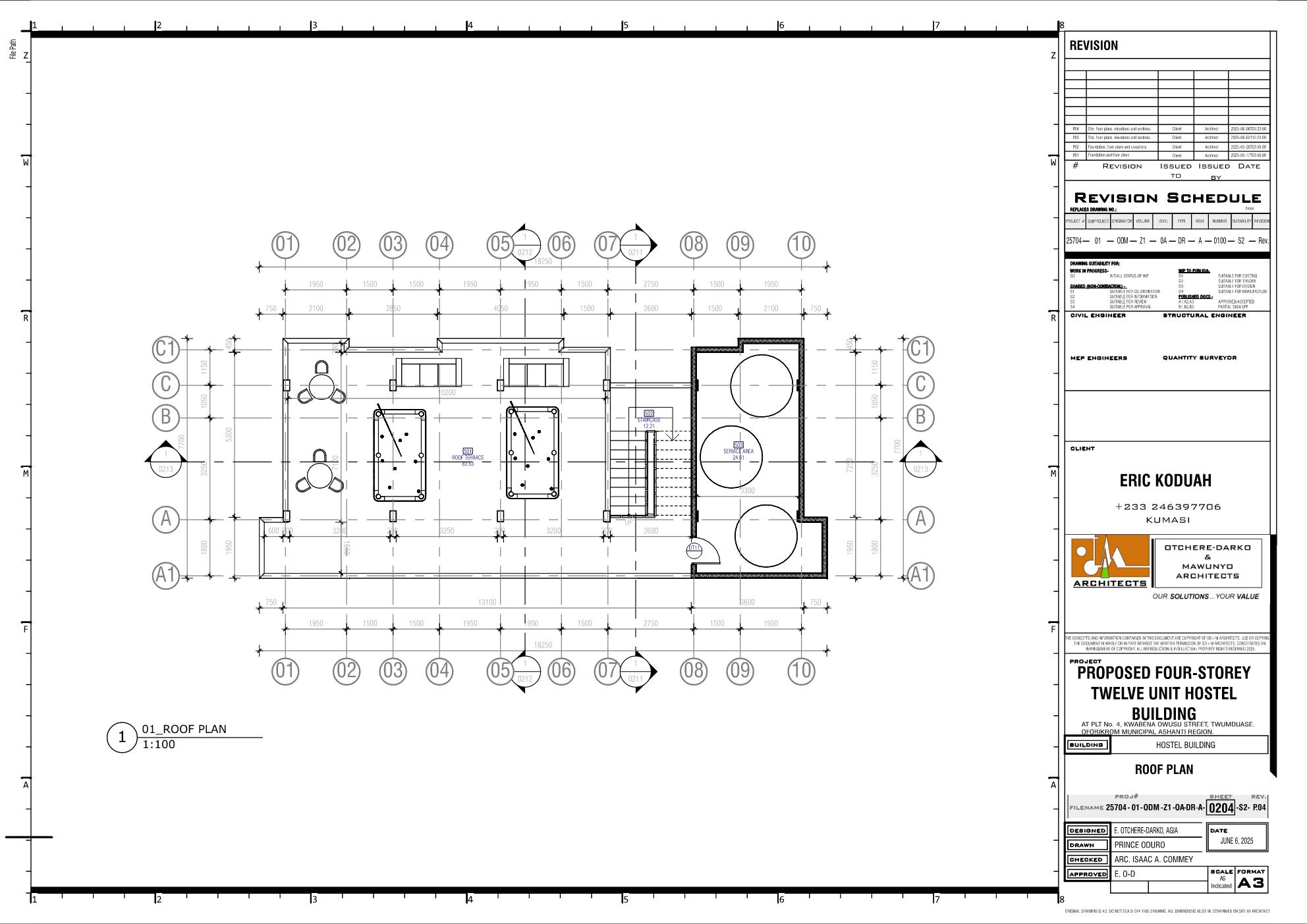

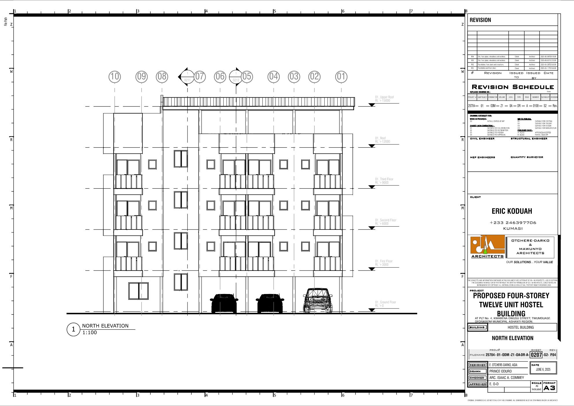

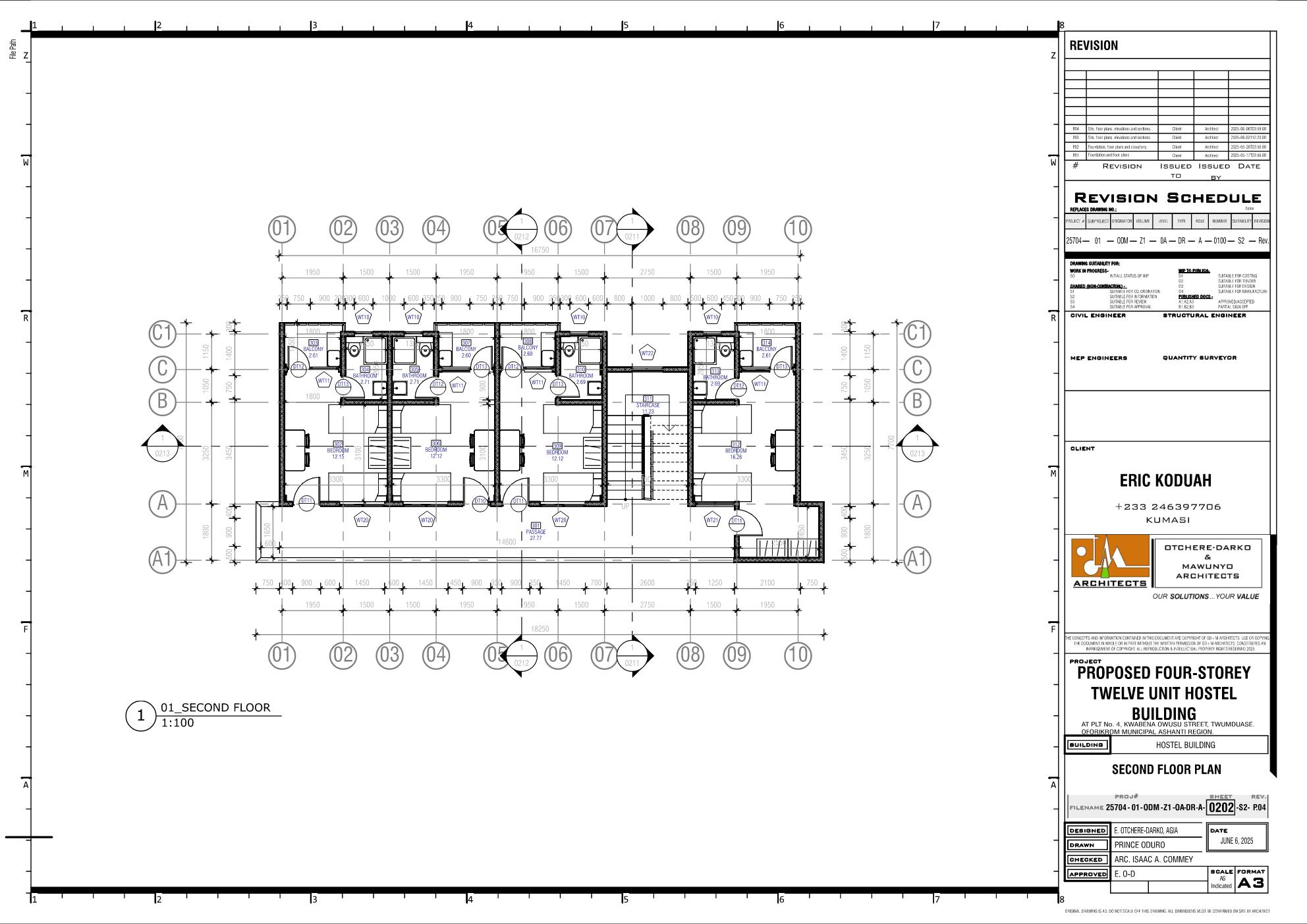

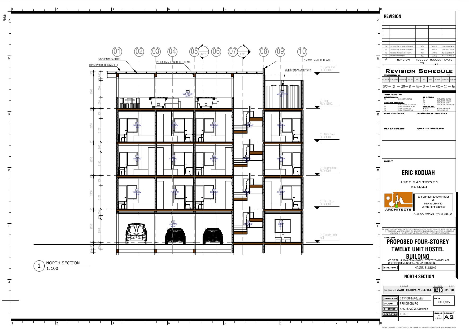

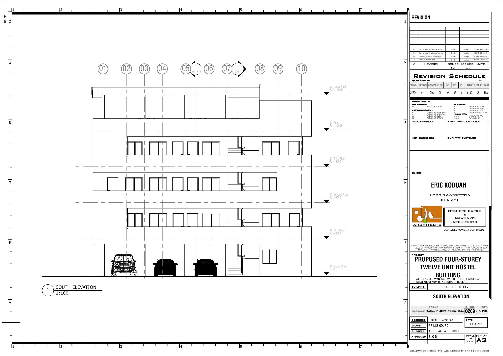

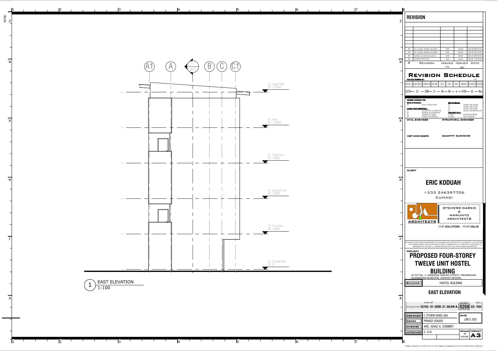

This is a WIP project and even though not yet complete I want to share with the community where my baby steps in Bonsai are leading me to!
Perspectives
Perspectives2
Perspectives3
Perspectives4
gndFlr
Flr1
Flr2
Flr3
RF1
RF2
ELEV1
ELEV2
ELEV3
ELEV3
SEC1
SEC2
Everything is Bonsai. I don't know how to do rendering in Blender so I had to export the .ifc model to .fbx and import it in Lumion for the rendering. I have received material resources freely shared by Theoryshaw and studying to understand how materials, textures and lighting work in Blender so I can finally do end-to-end projects in Blender.
Comments for improvement are welcomed!

  • @Owura_qu This is an outstanding job. Did you often encounter errors while working on this project?
  • edited April 6
    Thanks, and (with much gratitude to the community) the errors I encountered for this project were minimal compared to my early days when I had very little understanding of Bonsai. I can attribute the following to my improved understanding of Bonsai;
    1. Reading the posts of others on this forum and learning from the experiences.
    2. Posting my errors for help where I MUST and reading the IFC/ Bonsai documentation where I CAN.
    3. To reduce frustrations ifcGit is a must-use for "undoing" seemingly irreversible errors.
    4. It is motivating to have a learning partner to journey along with (outside the forum). For me having @steverugi :) is like a busy antenna always signaling the bright side of Bonsai irrespective of errors.
    5. This is a great forum with great contributors (I cannot mention all their names) but if you're an architect and you see a notification, especially from @theoryshaw and @Ace you must pay particular attention.
    I am very hopeful about the future of open source enough to gamble the transition from over a decade of mastery of Revit to Bonsai, and I know the initial productivity loss is gradually being rewarded. Initially, errors may scare you to go back to your comfort zone but the quick response from the community and developers to resolve these errors is incredible!
    So for me, errors don't scare me anymore.

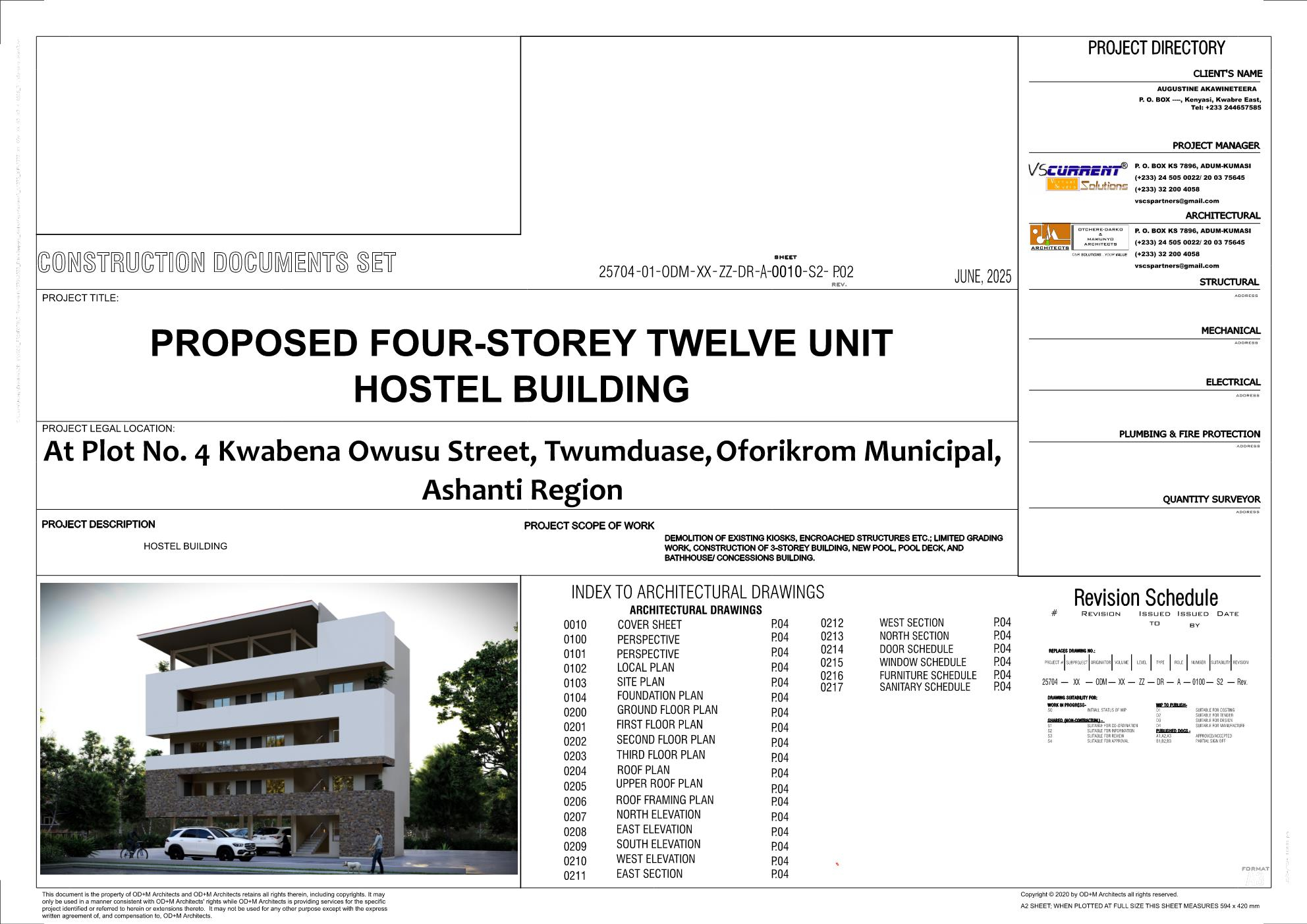

  • edited June 18
    This is a project created using Bonsai

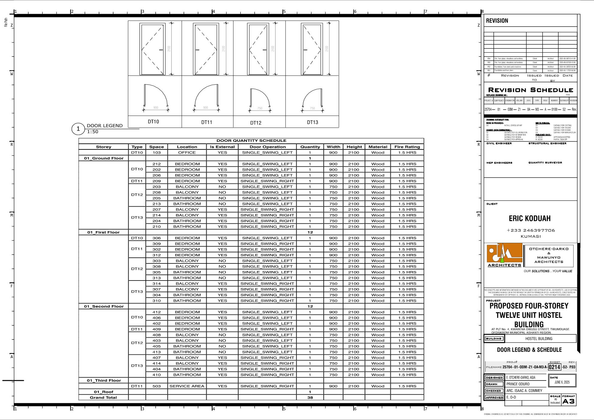

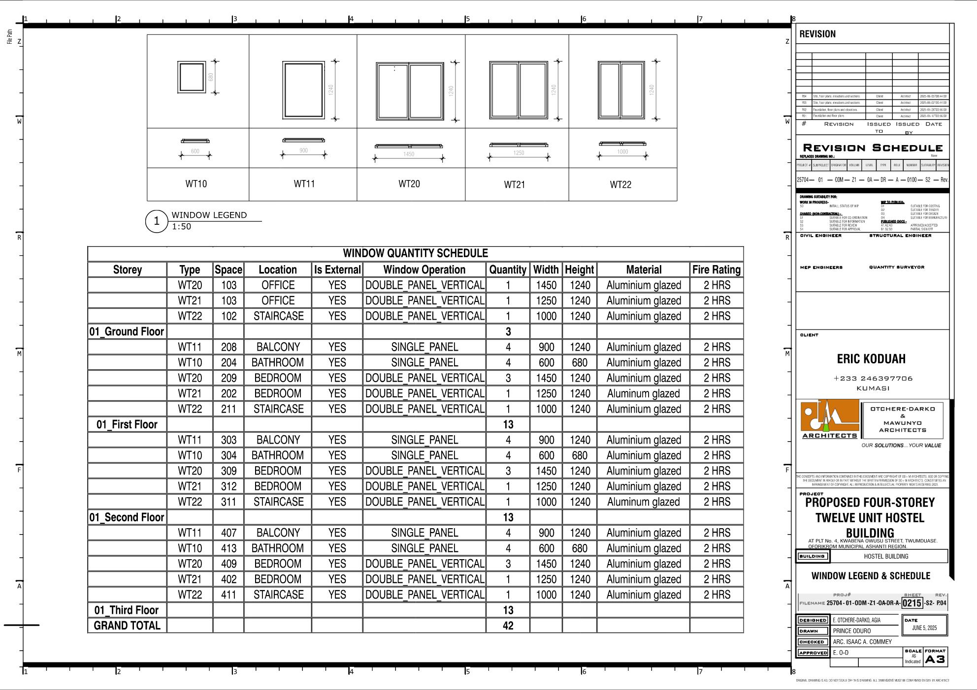

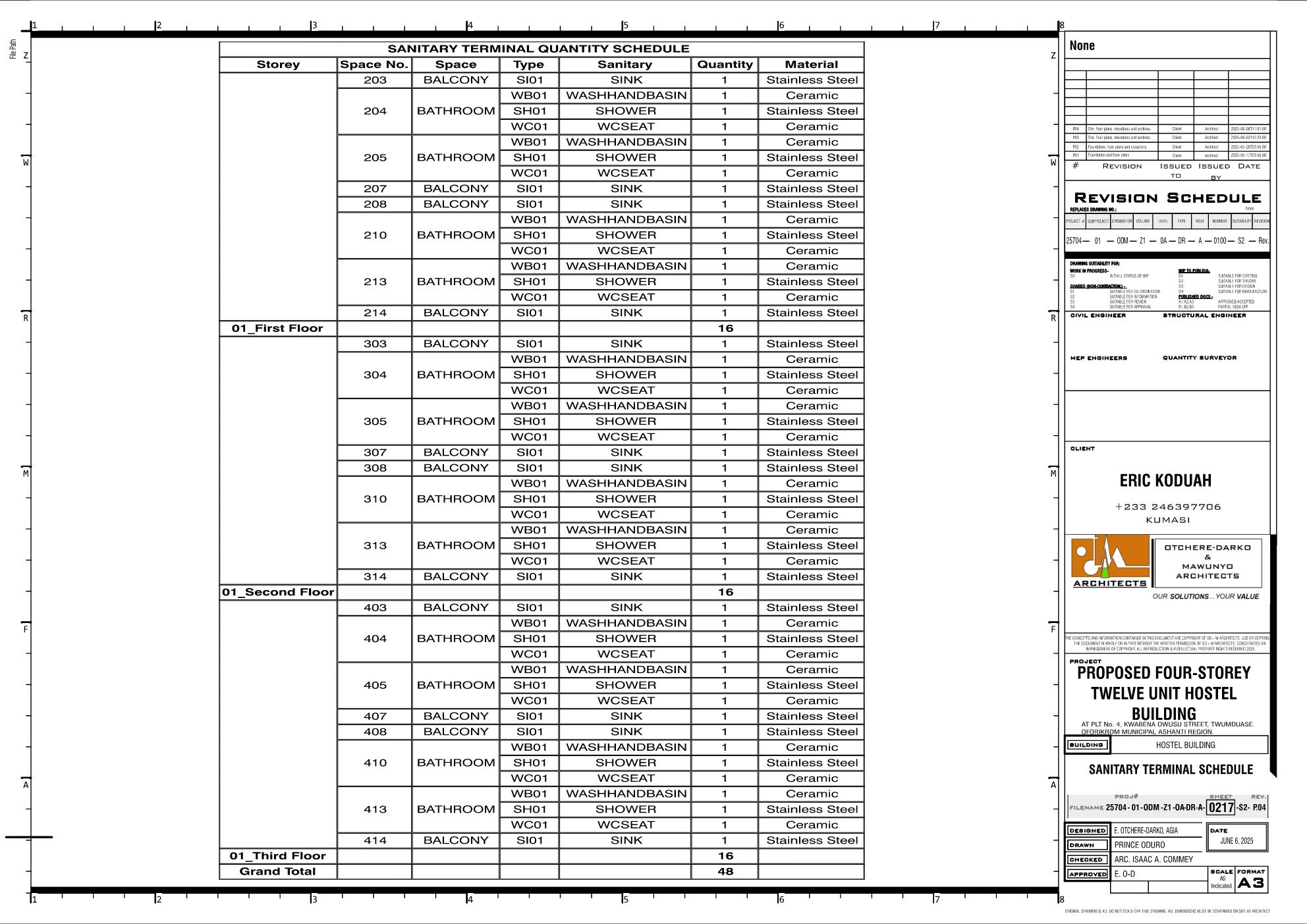

  • edited June 20
    @Prince_01 said:
    How did you generate the door and window legend with annotated diagrams of windows and doors?
    carlopavduarteframossteverugiOwura_qu
  • I suspect he simply arranged some models, set up a drawing, then used annotation lines to frame it, and dimensions annotations. i.e. hand-built, not automatically generated.
    Theoryshaw does something similar to add detail drawings of wall build up to his documents.
    duarteframosarunarchitect
    But one thing not to forget is to make sure you filter out those placeholder models used for the legend so that they don’t also populate and falsely inflate the quantities in the schedules.
    sjb007
  • @Owura_qu said:
    I followed the same approach—arranging some models to generate the legend—but it should ideally be filtered to exclude items from the schedule.
    I'm hopeful that Bonsai will soon reach a stage where legends can be generated automatically. I was introduced to Bonsai a few months ago by my mentor, @Owura_qu, and I’ve truly been enjoying the experience. Thank you, Sir.
    duarteframosarunarchitectOwura_quMassimo
