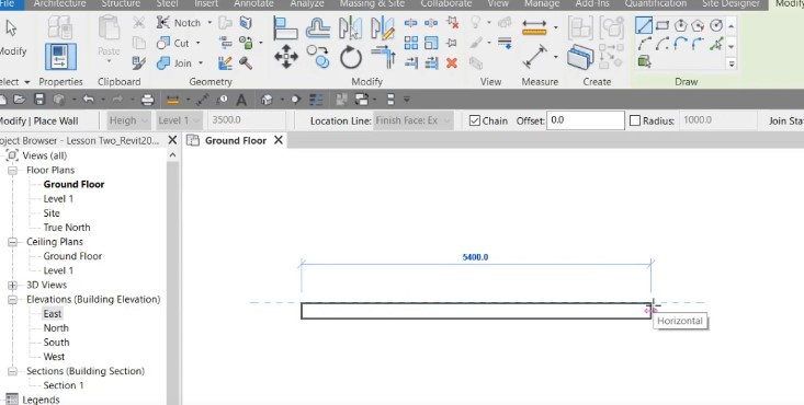

I do like in Revit when drawing a wall there is some dimension feedback annotation, can we do that in Bonsai?

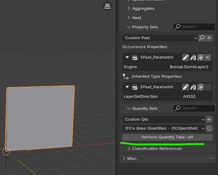

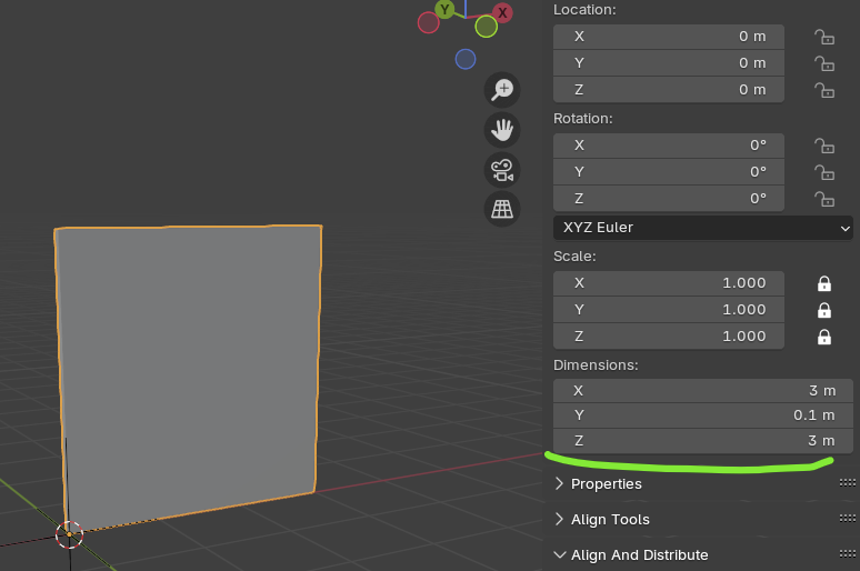

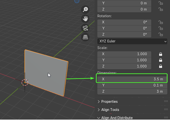

    1. you can run "Perform Quantity Take-off" to extract quantities from your elements

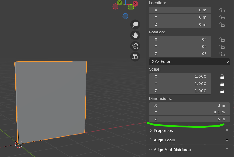

    1. or press 'N' to get the right panel, check "Item"

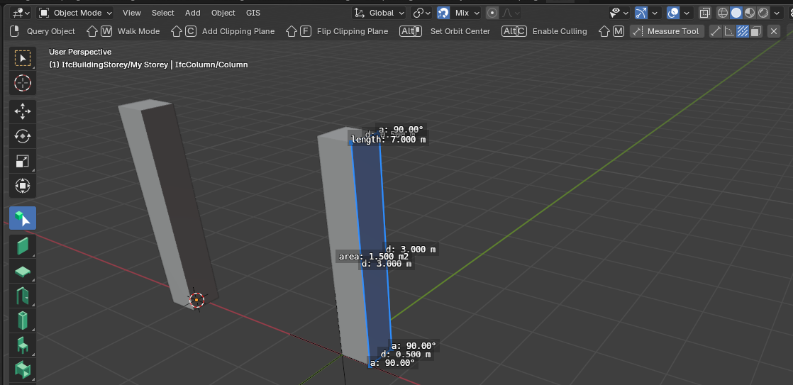

    1. or use "measure" tool from the left panel

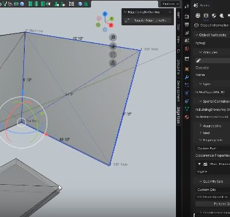

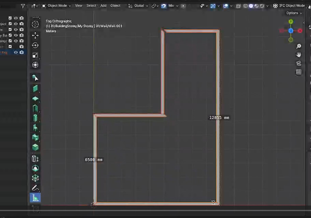

    Skynet wrote a script...

  • @theoryshaw why not a PR 😉?.
    Really handy.
  • Dear Skynet, can you make a PR? ;)
    I think it would be a good tool to be integrated as well, but will leave it to other more qualified to make the integration. Want to try?
    Best, Ryan

  • @theoryshaw Sure! :) Where would you think it would make sense to add it?
    Add the "Toggle Edge Lenghts" as an icon in the "Explore Tool"?

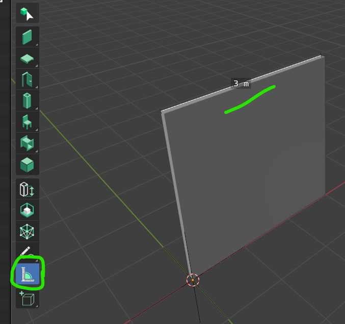

    In my previous post I forgot to mention @theoryshaw 's method using the Explore Tool > Shift+M to turn on the Measure Tool
    Not having figured out how to only show certain values it looks a bit too messy for me, but it's a matter of taste of course

    wouldn't it be a kind of duplicate of what already available ?
  • @steverugi you are right! It is true that the N panel has the bounding box information. The same info is in different places.
    @wayneh150 What do you think? if you press N, you will have that information already there.

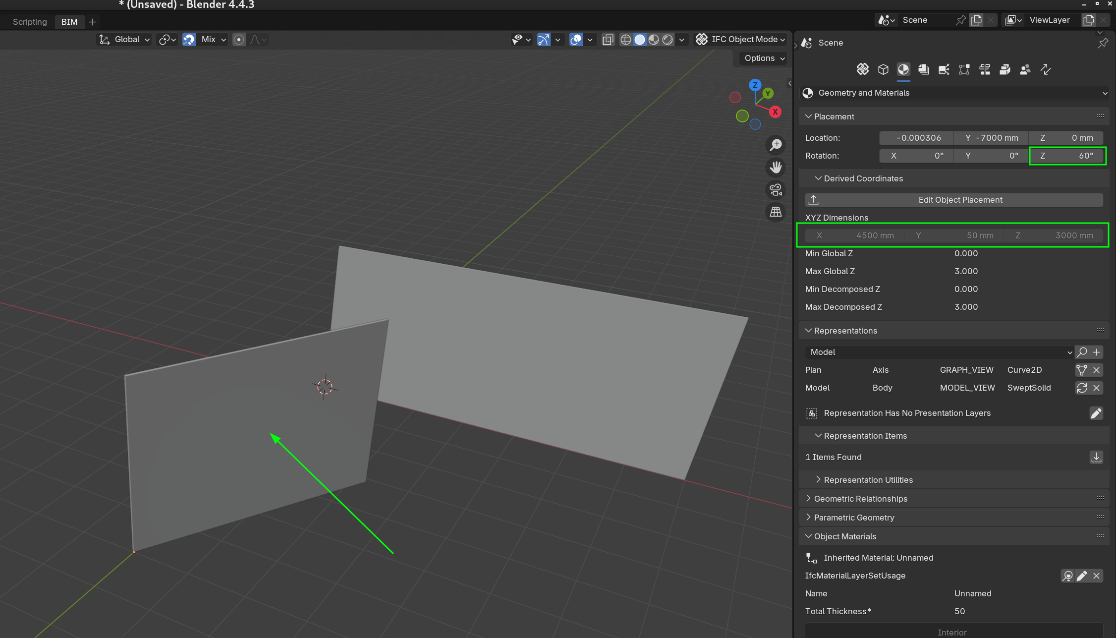

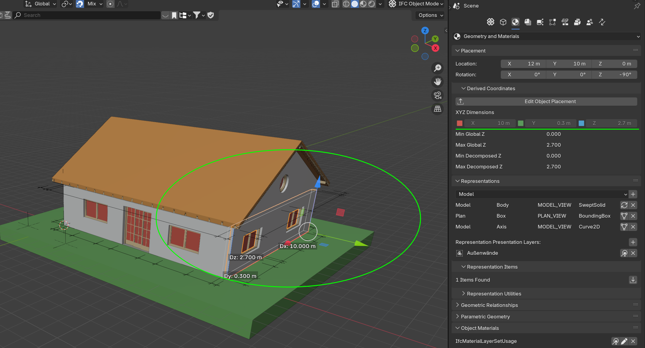

  • Actually I was looking to the sourcecode and there is BIM_PT_derived_coordinates(Panel). So in Geometry & Materials -> Placement -> Derived coordinates: XYZ Dimensions

  • edited May 12

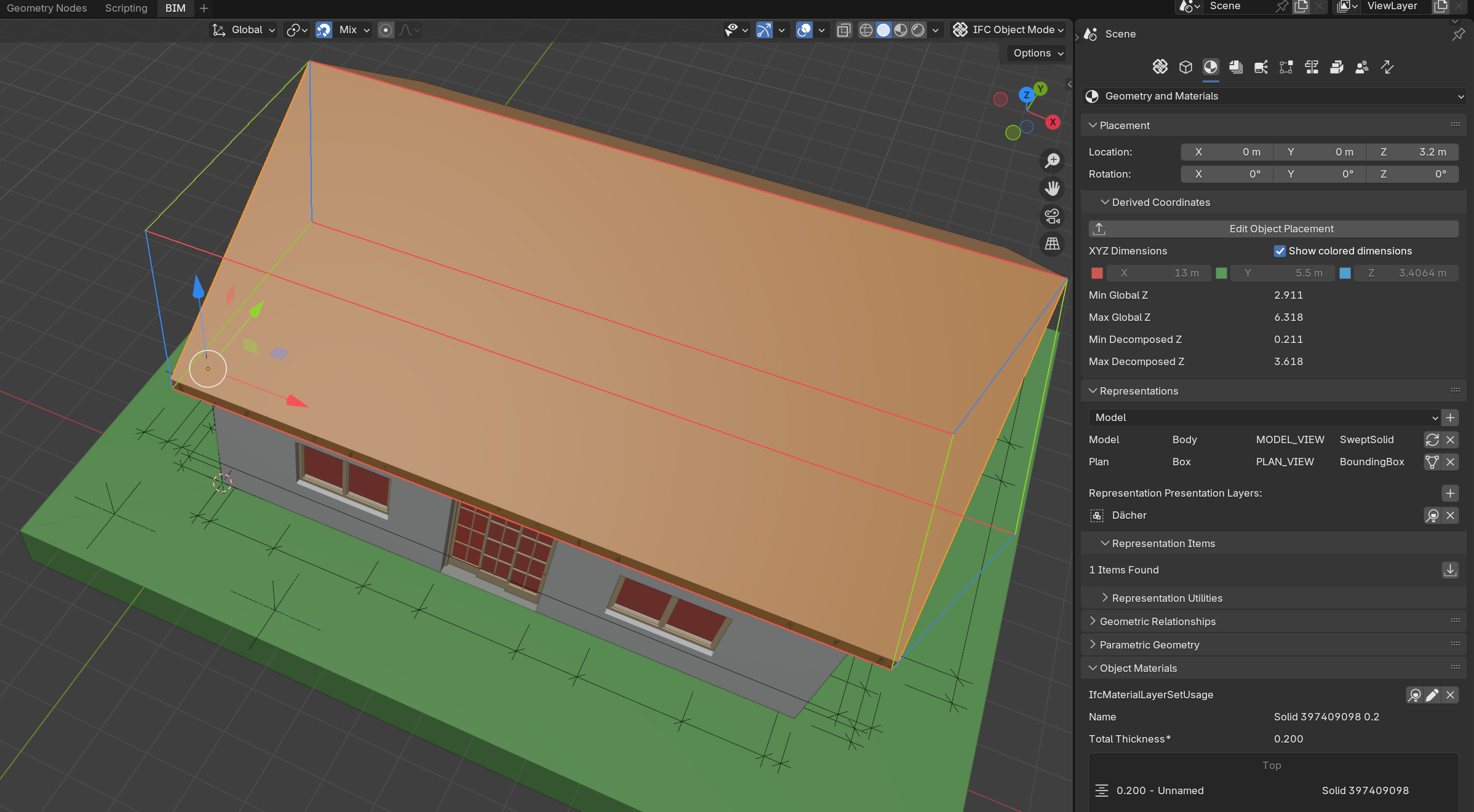

    Since we have the information in "Geometry and Materials", what do you think about adding a checkbox (Show Locals Gizmo) there to show the local gizmo and a bounding box with the same color as the axis?
    John
    The bounding box is useful to identify an object that's a good idea 💡

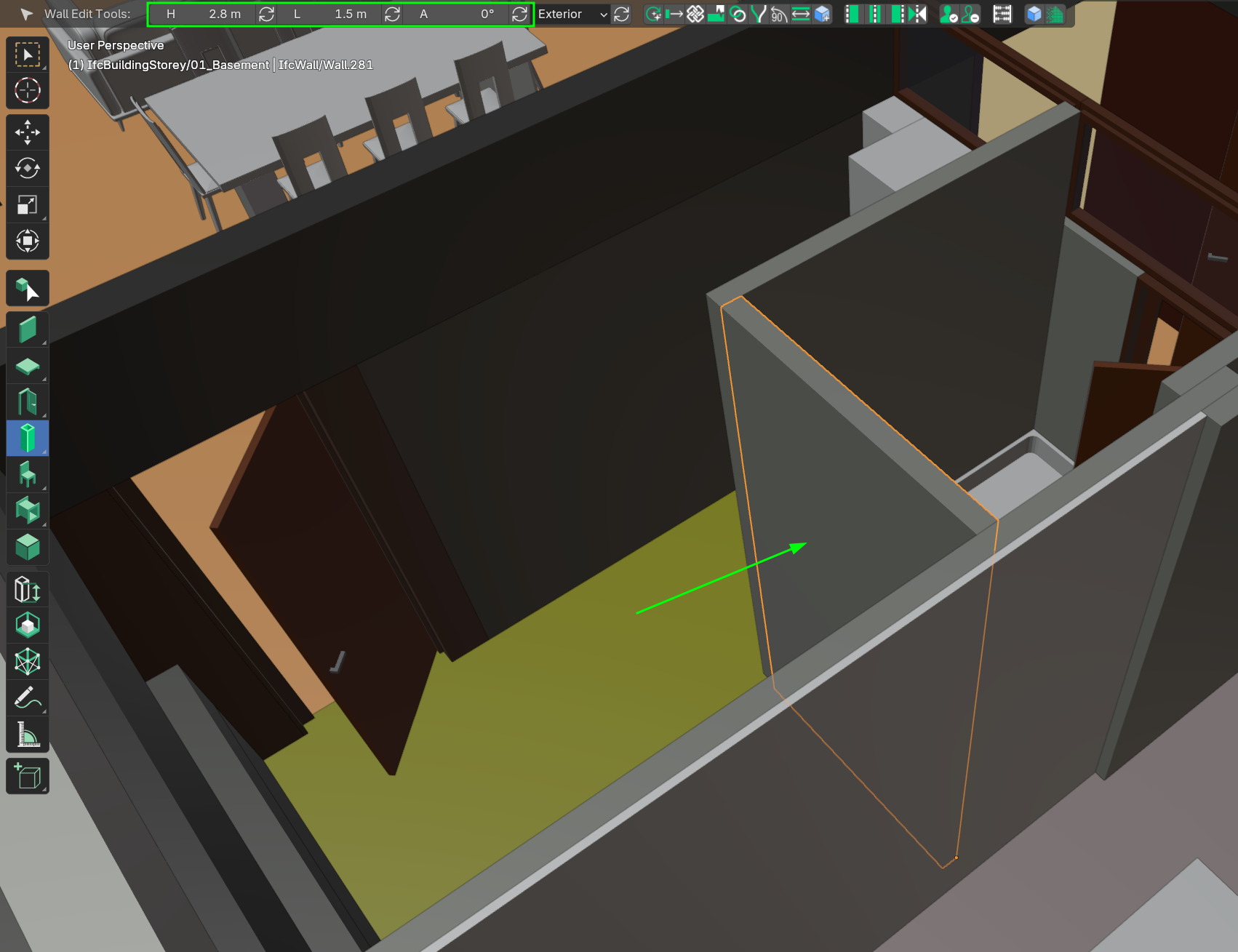

    I thought I would go through and experience a tutorial by IFC Architect and look for areas new users might find difficult to do,
    With a view to deliver a 45 min introduction and onboard rooms full of supply chain and entirely new users to Bonsai and native IFC.
    One of the early comments around UIUX was
    "How do I know how long my walls are, and how do I adjust a wall to 12500mm if I make a mistake?"
    My natural thought would be
    1.Which wall is what dimension?
    2.click a dimension button or shortcut ,
    3.snap to two points to anotate
    4. Click to position the annotation distance from the wall if not automatic.
    or
    a.click the wall object
    b1.type the dimension
    b2.or move a grab with live feedback.

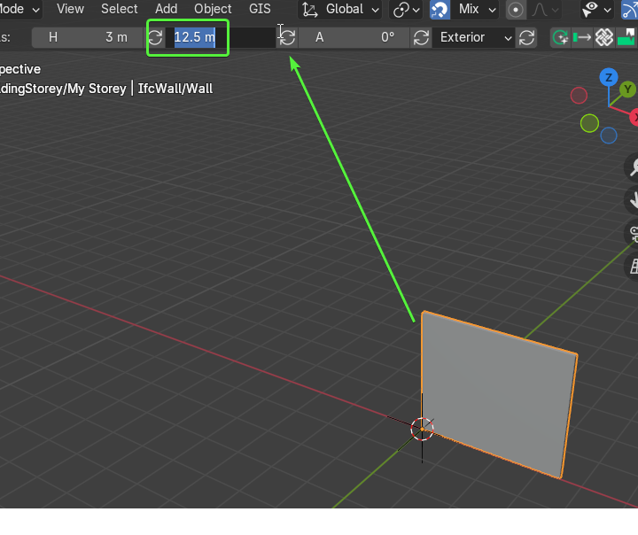

  • edited May 13
    @wayneh150
    please try:
    How do I know how long my walls are?
    not to mention that when modeling it's good practice (for me) to use axis and numpad to set length
    last but not least, if you have gridlines in place you can use them to extend/trim, or use other walls for the same purpose

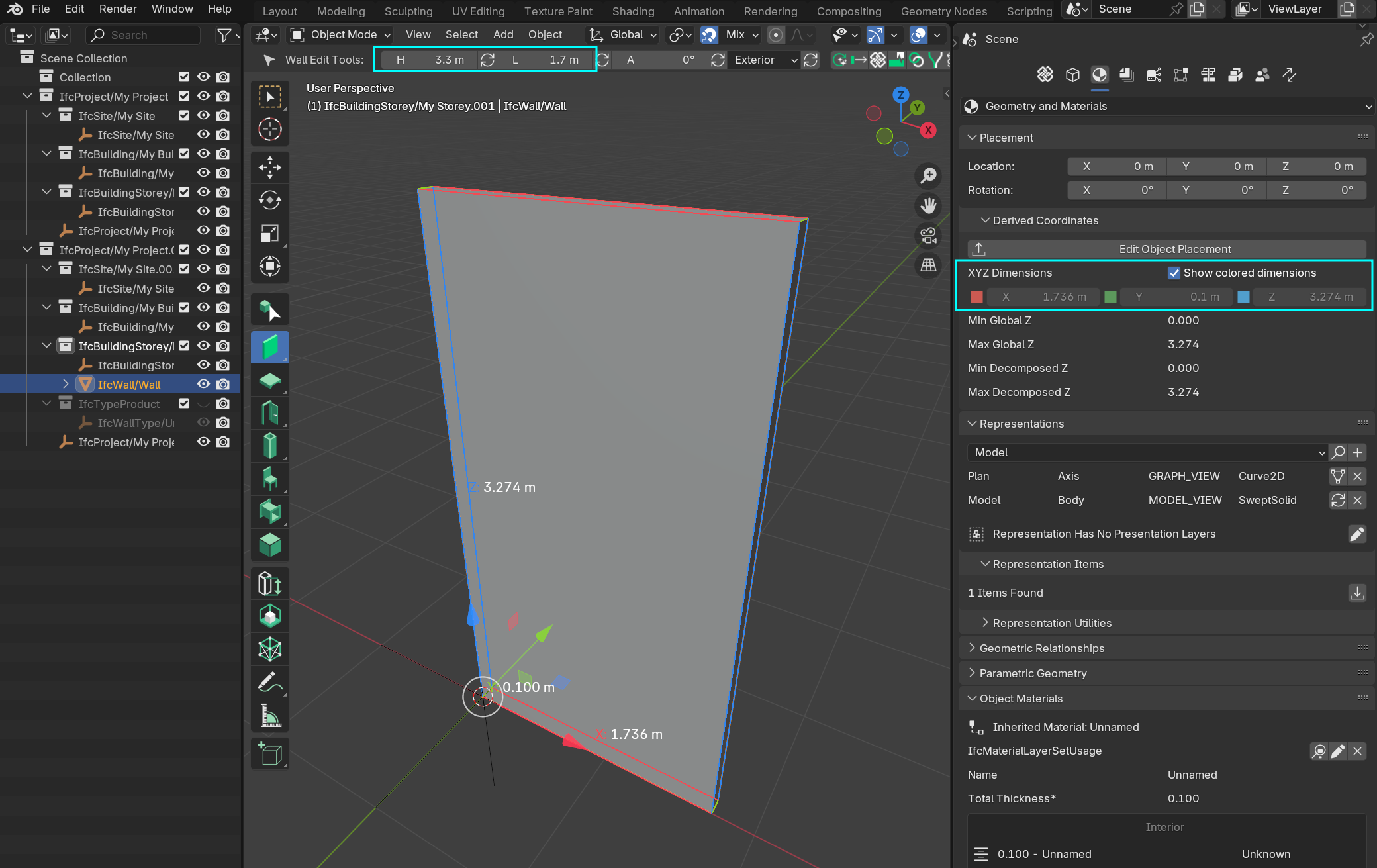

  • edited May 13
    Minor changes. Better layout and exact same rgb for the bounding box edges as for the local gizmo axis
    As @steverugi mentioned you can use the dimensions in the N Panel.
    Other option in to look to the "XYZ Dimensions" in the "Derived Dimensions" from the "Geometry and Materials" TAB.
    Here the PR Derived dimensions: Show colored dimensions #6698
    John

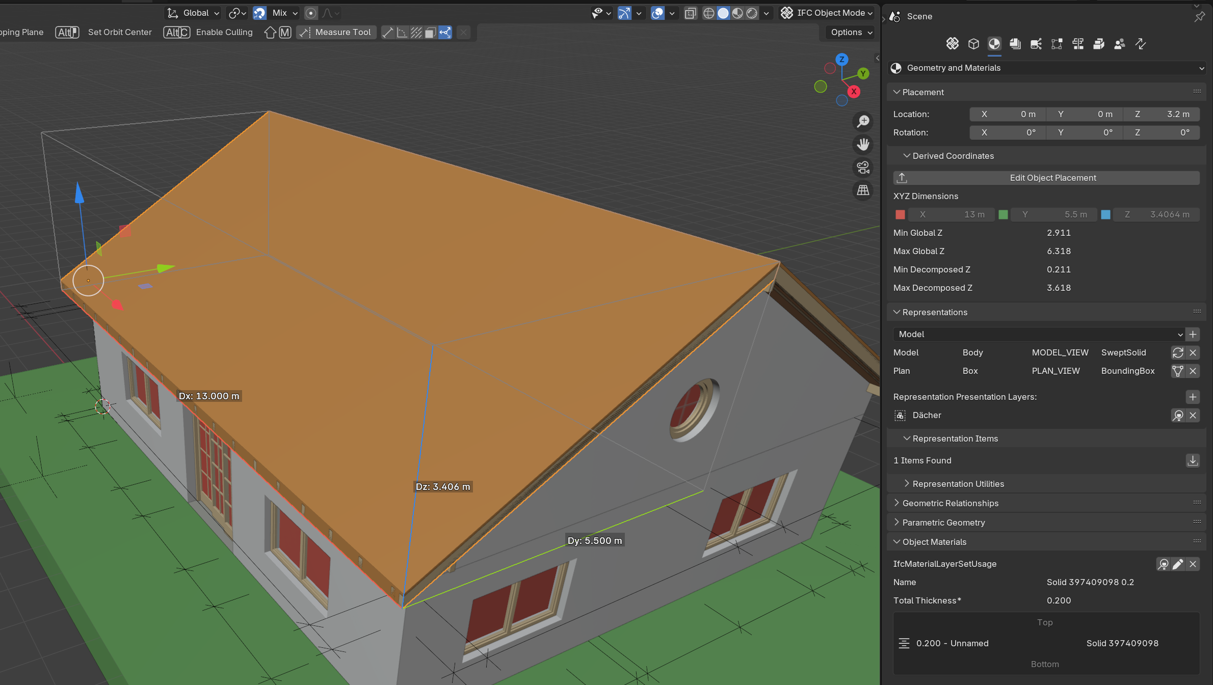

  • As per feedback:
    duarteframosMassimosteverugiwalpaAntonio_DiasDarth_Blender
  • Adding nice formating for units already available in Bonsai

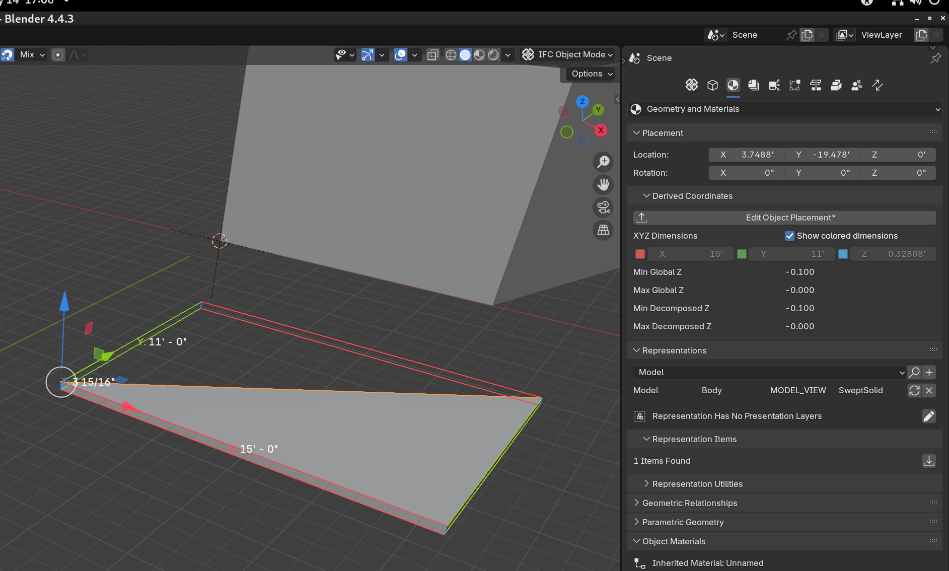

    thanks @theoryshaw !
    theoryshawzoomerwalpaMassimoNigelJohnDarth_BlenderFranSeoane

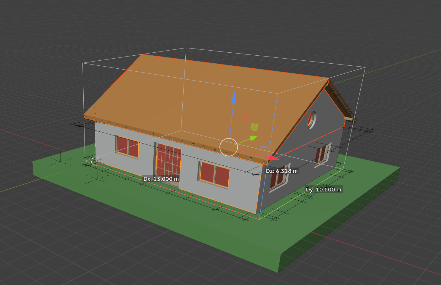

  • Improved layout (hopefully) and possibility to select multiple objects. Moved to explore tool as per discussion in https://github.com/IfcOpenShell/IfcOpenShell/pull/6698
    wayneh150zoomer
  • Same style for the texts as the rest of measuring tools
    Massimo
    This is great thank you! looking forward to playing with it.
