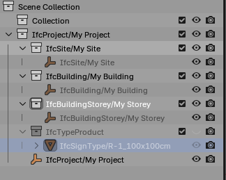

    Here is what I've tried so far.

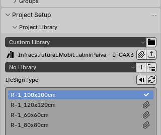

    1. Start Blender/Bonsai and create a new IFC4x3 project
    2. In Project Setup, Project Library select InfraestruturaEMobilidade_ControleEMonitoramentoDeEstrada_SinalVerticalDeRegulamentacaoR-1_WalmirPaiva.ifc
    3. In the Top Level Assets box, select IfcSignType and R-1_100x100cm. Press the paper clip button to add the sign type to the project

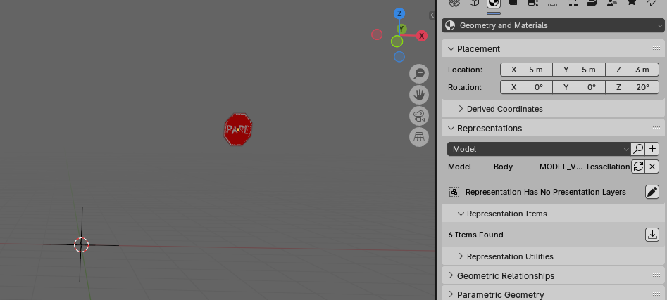

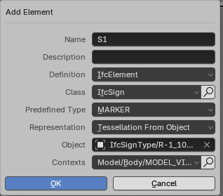

    4. Add an instance of the sign to the model . Requires selecting the IfcSignType before adding the IfcSign instance. If I try to assign the IfcSignType to the IfcSign later, BB crashes.
    5. Position the sign
    This all works great. So now some questions:

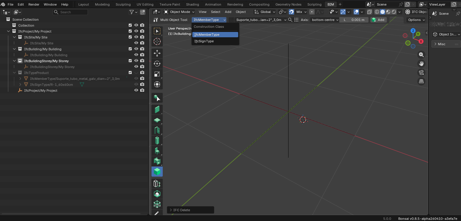

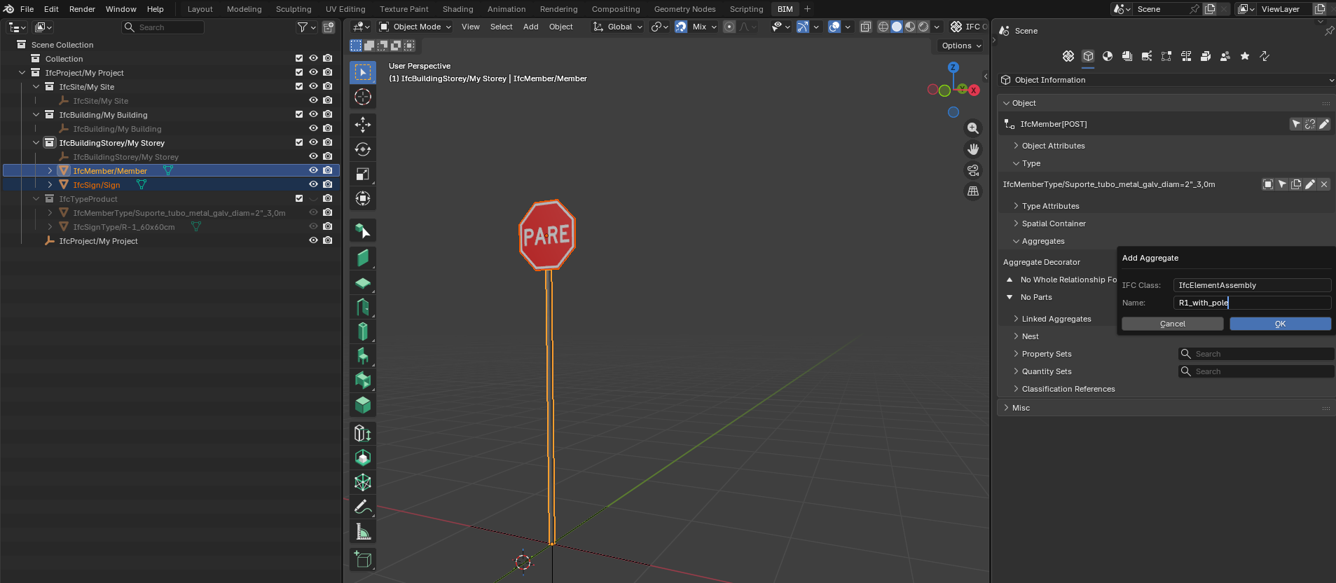

    How to add the sign post?
    How did you create the sign library? I'd like to do something similar for US signs.
  • @Rick_Brice
    After importing the objects, signal and pole (in the file InfraestruturaEMobilidade_ControleEMonitoramentoDeEstrada_SuportesParaSinalizacaoVertical_WalmirPaiva.ifc):
    1 - Create the instances using the Multi Object Tool.
    2 - Reposition the objects.
    3 - Select the two objects and create the assembly.
    Pay attention to the cursor position, as the IfcElementAssembly is automatically created in this location.
    If you want to make linked copies, use "linked aggregates" as shown by theoryshaw here.
    Cheers

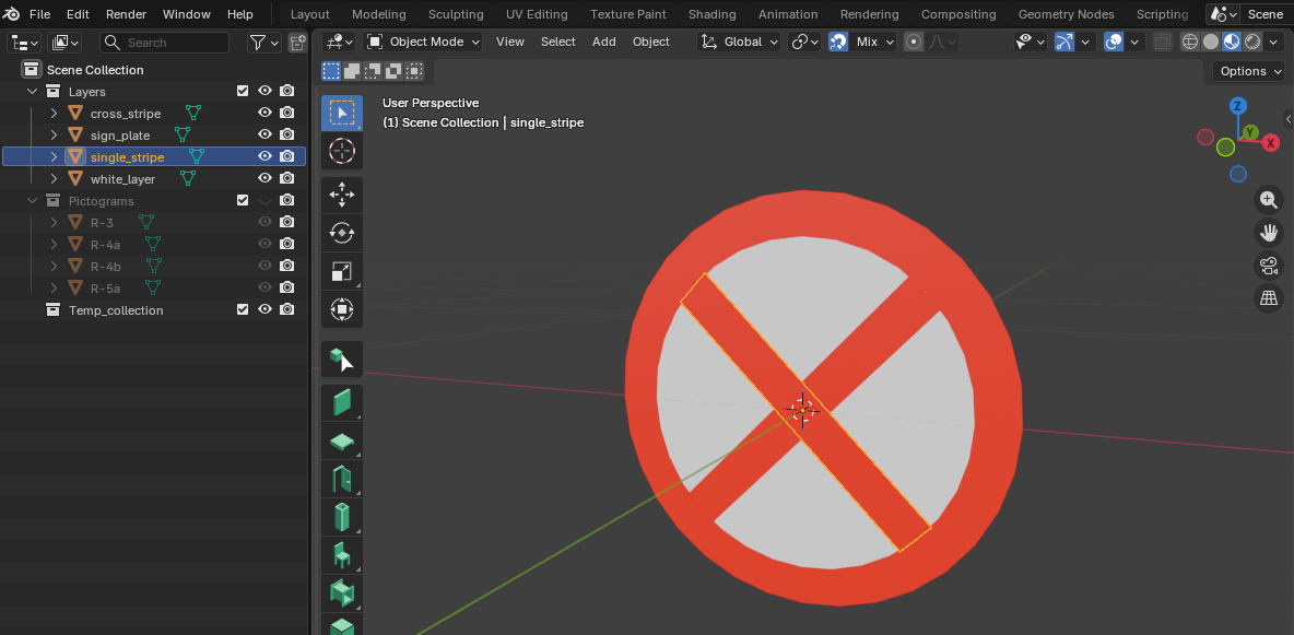

    Steps:
    1 - using INKSCAPE I copied each sign and changed the scale to a known value (for example 500x500mm to obtain a sign with a diameter of 50cm) and export as svg.
    2 - Import the svg into Blender.
    3 - using a circle of the same diameter in Blender as a reference, reposition the pictogram to a position (0,0,0).
    4- Create the collection structure with the objects from the layers that are repetitive (each with an appropriate positioning to appear in the correct layer order, see the attached file)
    5 - Run the script 'change material pictogram.py' to change the materials that Blender creates for each imported SVG, to a material with the name of the style that will be created in the ifc file (I used "black_color" for the pictograms)
    6 - Run the script 'reposition pictogram.py' to rotate the pictograms and apply a height corresponding to the layer
    7 - Create a new IfcProject
    8 - Run the script 'create ifc types.py' (remember to fill in the lists in the script with the names of the pictograms for the sign that have a single stripe or a cross stripe)
    9 - To create identical signs but with different dimensions, psets and classifications, I made a specific script for that.
    Well, that's it... I hope it's useful
    Greetings

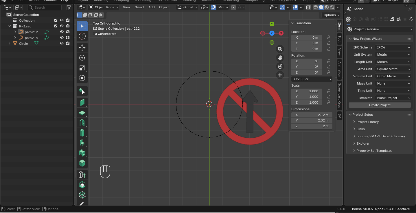

  • I was able to convert all the published sign images from EPS to SVG.
    I was unable to convert them of IfcSignType.
    The problem starts when I run the 'change material pictogram.py' script. The "black_color" isn't defined.
    Here is one example of the 407 I have.
    Any advice on how I could make this to work? Maybe it can be automated since I have 407 sign files.
  • Sorry, I forgot to mention that Blender requires a material with that name to already exist. Just rename any material created by the import to the name you want and then run the script.

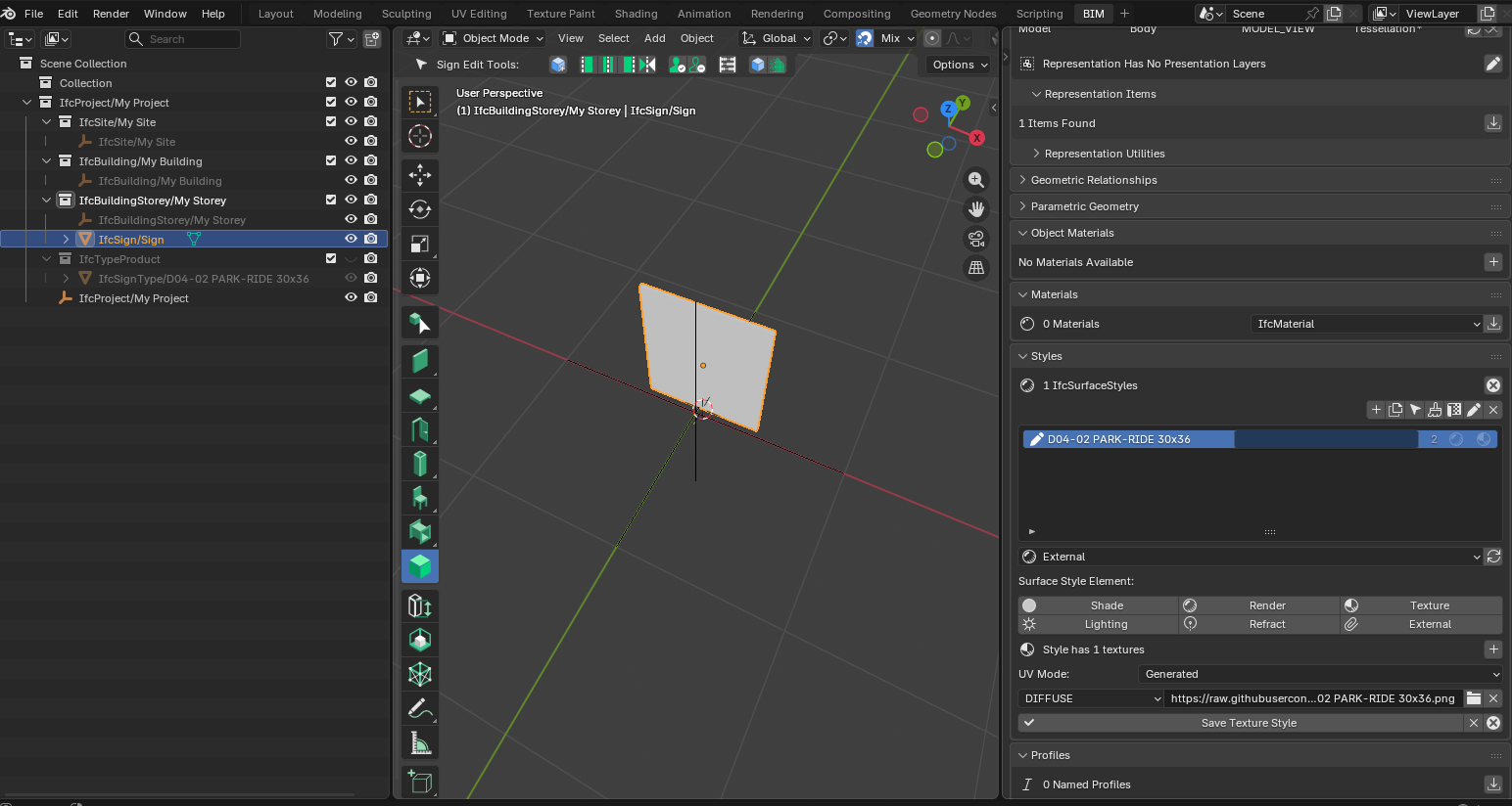

    I went the route of using textures. I like this approach because it doesn't add a lot of data to the IFC file and the sign imagery can easily be turned off by not displaying textures. From an engineering perspective, the sign data (type, size, location and orientation) is more important than the image of the sign face.
    I created a prototype for what could become a national sign library resource. It is published at https://github.com/RickBrice/IfcTrafficSignLibrary.
    Even though the IFC specification says that for IfcImageTexture.URLReference http is a common protocol, Bonsai doesn't support this. To get around this problem, I created a PR https://github.com/IfcOpenShell/IfcOpenShell/pull/7961
    You feedback is appreciated.

    I tested it with today's BB version but it didn't work; the link is there, but the texture didn't update.
    Any tricks?
    I personally don't really like the idea of ​​external links. I know it's better in terms of file size, data usage, protocols, etc... but my years of experience struggling with broken external links in dwg and xls files have left a bitter taste in my mouth. ;)
    Cheers
  • If you toggle on the system console, there is probably an error message that it can't load the file. The filename will be a mix of a local drive and the https URI. This is a short coming in bonsai. The PR is intended to address this.
    To use the PR, you'll need to use the live development environment and switch to the rab_IfcImageTexture branch
    I get the drawbacks of external files. I'd like to create a parallel version of this library using your technique. I'm just not skilled enough blender to make it happen. Also, there are so many files to process, I would like to find a way to do it in batch.
  • An alternative is to clone my repo, tweak the script so the URI is for your local file system.
